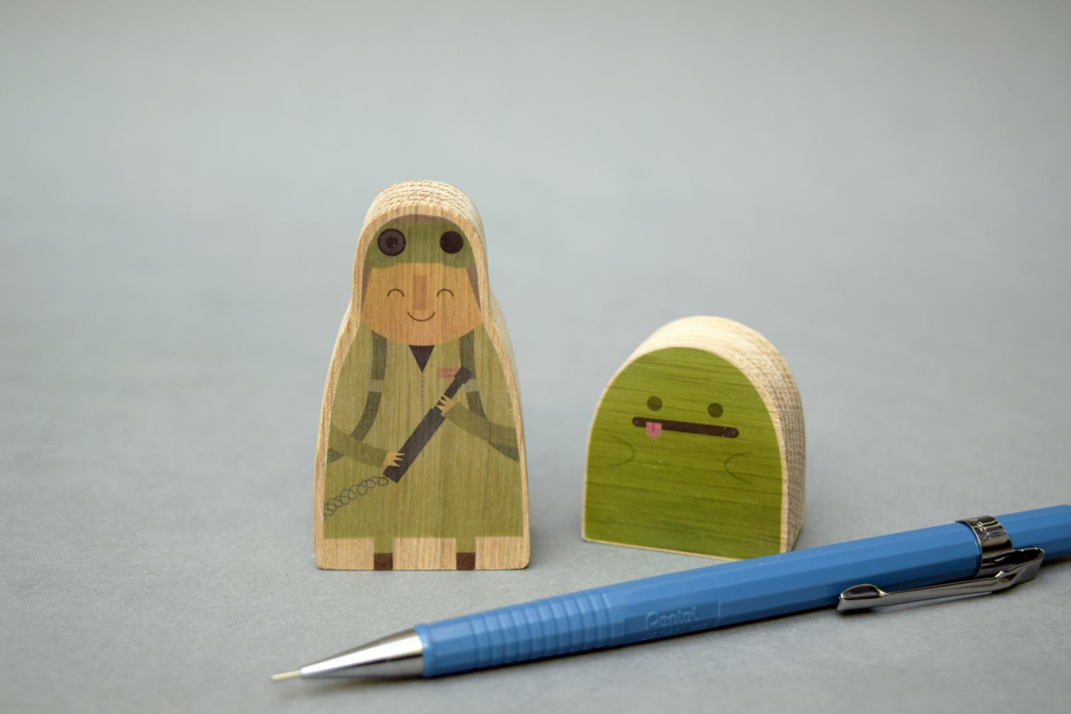

Hi, I've been playing with some new product ideas with two of my main stockists and we have developed some 2D timber figure concepts. You will get a set of two figures in a pair, a tall figure and a short figure, illustrated below in a dummy mock showing a ‘Ghost catcher’ and ‘Ghost’. (This is an 18mm oak with a clear matt printed sticker finish, unvarnished)
I am currently still trialling different timber types & thicknesses (15/18mm Oak hardwood or white birch ply are the current best results) and I am keen to explore various methods for applying the images, through clear printed sticky sheets, laser etched, hand painted, decals, screen printed and heat transferred.

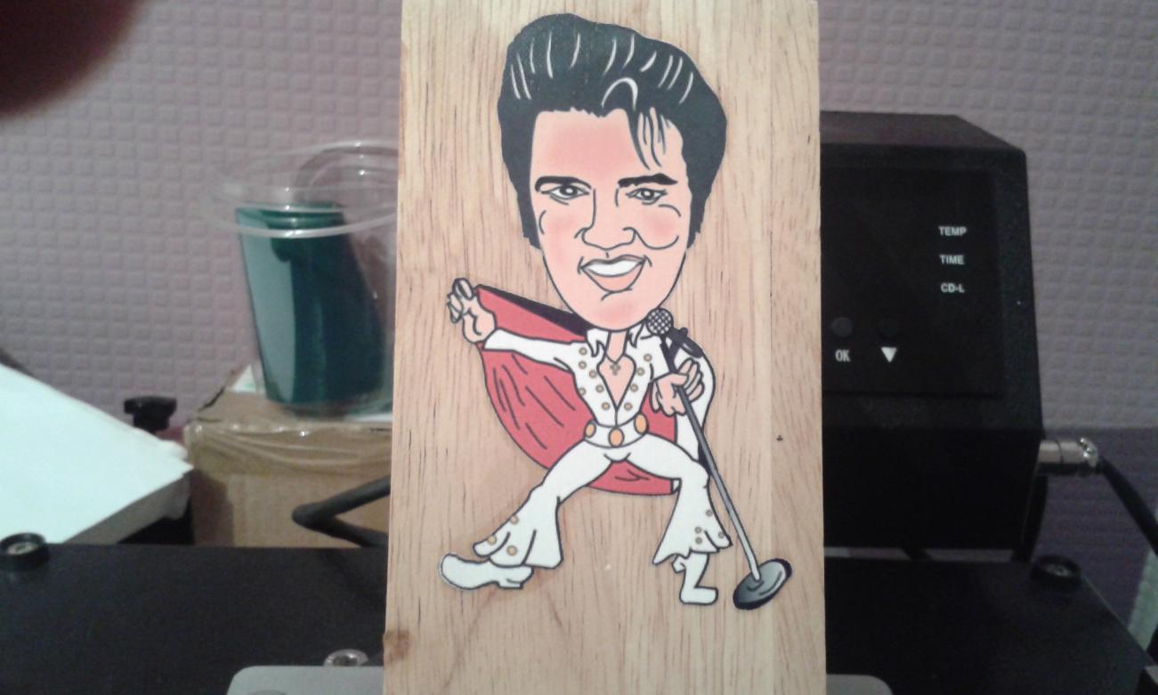

Here's an, admittedly rushed, attempt at using JetPro Opaque II transfer paper from Yolo on a scrap piece of wood, heat pressed at 175 deg for 30 secs. I covered it with a teflon sheet which maybe I shouldn't have done as it has left a textured pattern in places, particularly the hair, where the wood was also a bit uneven.
However.................... it worked!

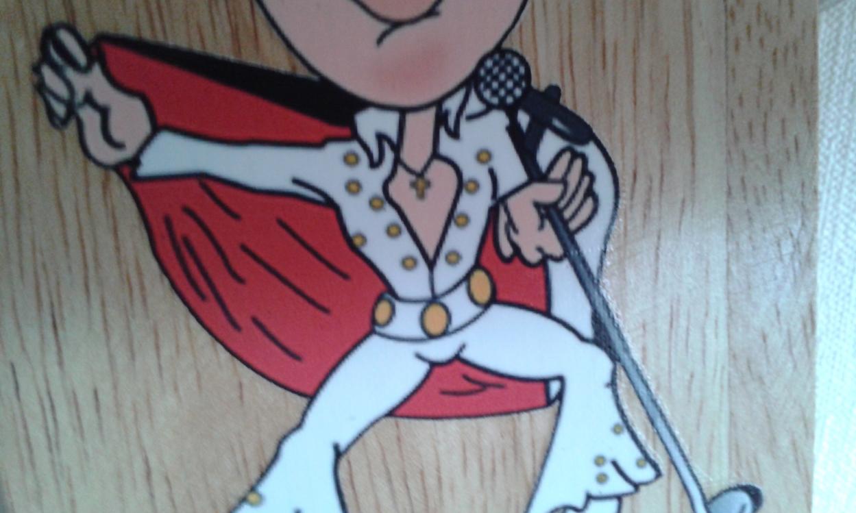

Close up, with some lacquer applied ...
Ok, definitely some more experimentation needed, but at least you don't need an OKI and white toner (this was printed on a Canon inkjet with dye inks) and I think you'll agree the whites are white. No good if you want the wood to show through though. You can also use sublimation inks.

Teh JetPro Opaque II transfer paper looks perfect in my opinion.
Colours may not be right just now, but they are close enough to say it will work with some proper profilling
