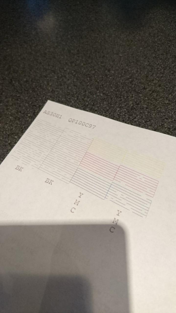

Got a WF7110 bundle from CityInk in an attempt to fix a horizontal banding problem with my Ricoh.
Unfortunately the thing is a heap of crap, for lack of a better word. Ive had it set up for a week and haven't managed to get a single perfect nozzle check out of the poxy thing apart from when I initially set it up, ive done ONE test print which came out streaky with horizontal banding.
Ive done close to 30 nozzle cleans (Im aware doing more than 3 is never recommended but what other options do i have?)
With every clean i do, the results get worse and worse.
Image attached for your viewing displeasure

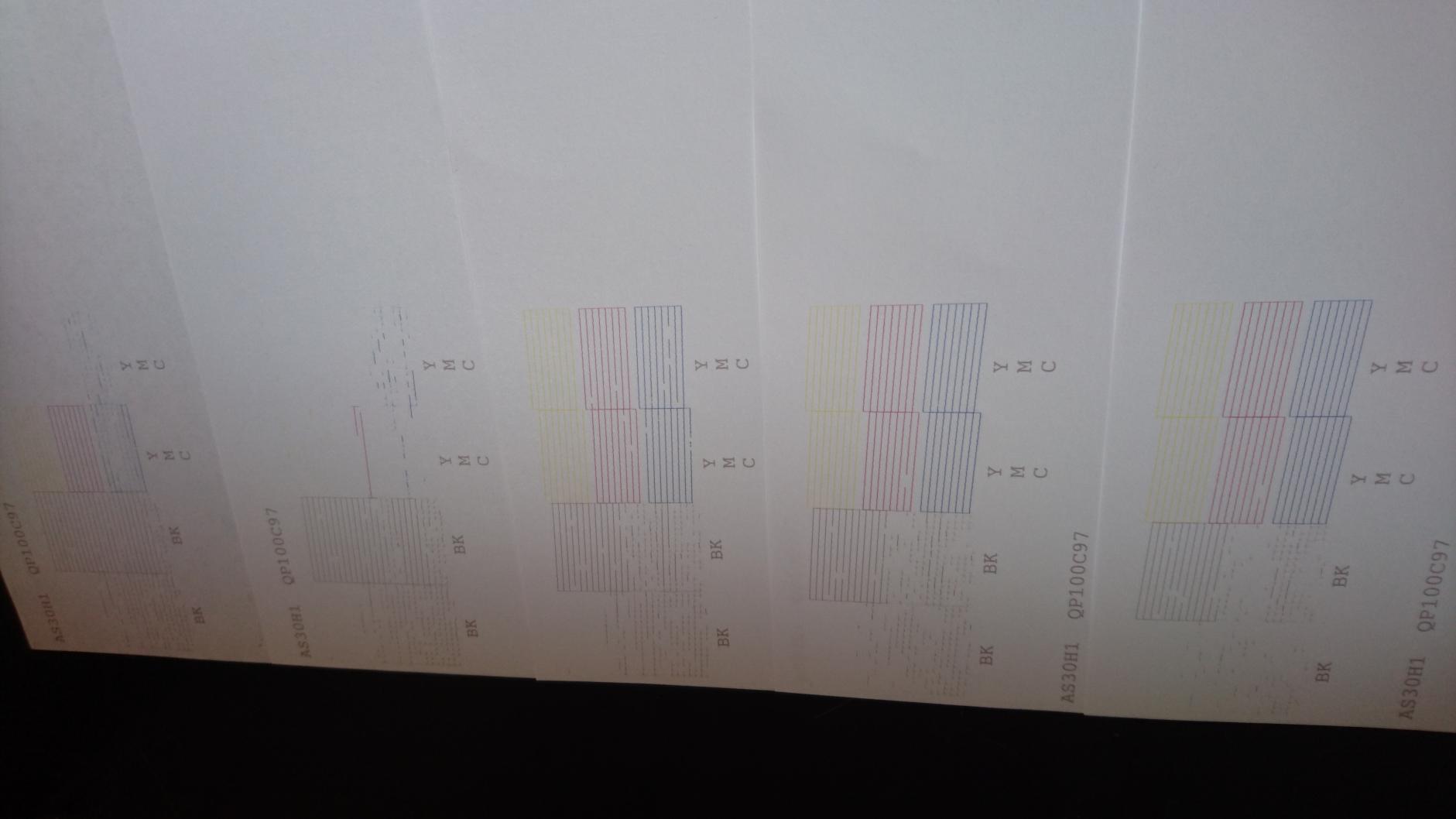

I didn't know about sawgrass support at the time, this was about 2 years ago when I first set up, then I discovered cityink last year and everything was spot on for ages. Sawgrass could have most likely resolved my issue, I didn't however like the sawgrass price tag but it's looking cheaper by the day at the moment!
I've had the 7110 for 2 weeks but only took it out of the box a week ago and set it up.
Just done more nozzle checks, black is looking terminal but colours are slowly getting better...
[ATTACH=CONFIG]4534[/ATTACH]

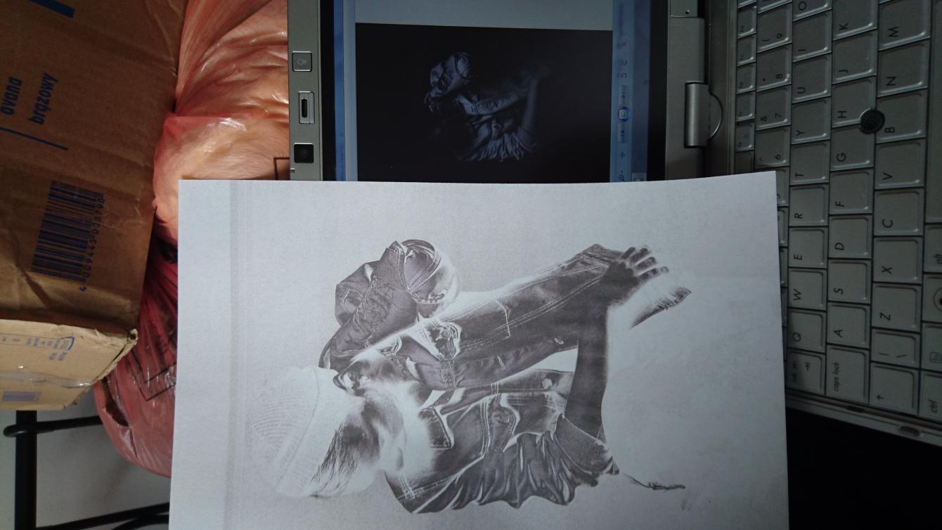

Complete print head failure now, tried to print a random black image from the Internet and got the attached image before the printer spat it's dummy out and now thinks there's no ink cartridge in it
[ATTACH=CONFIG]4535[/ATTACH]
