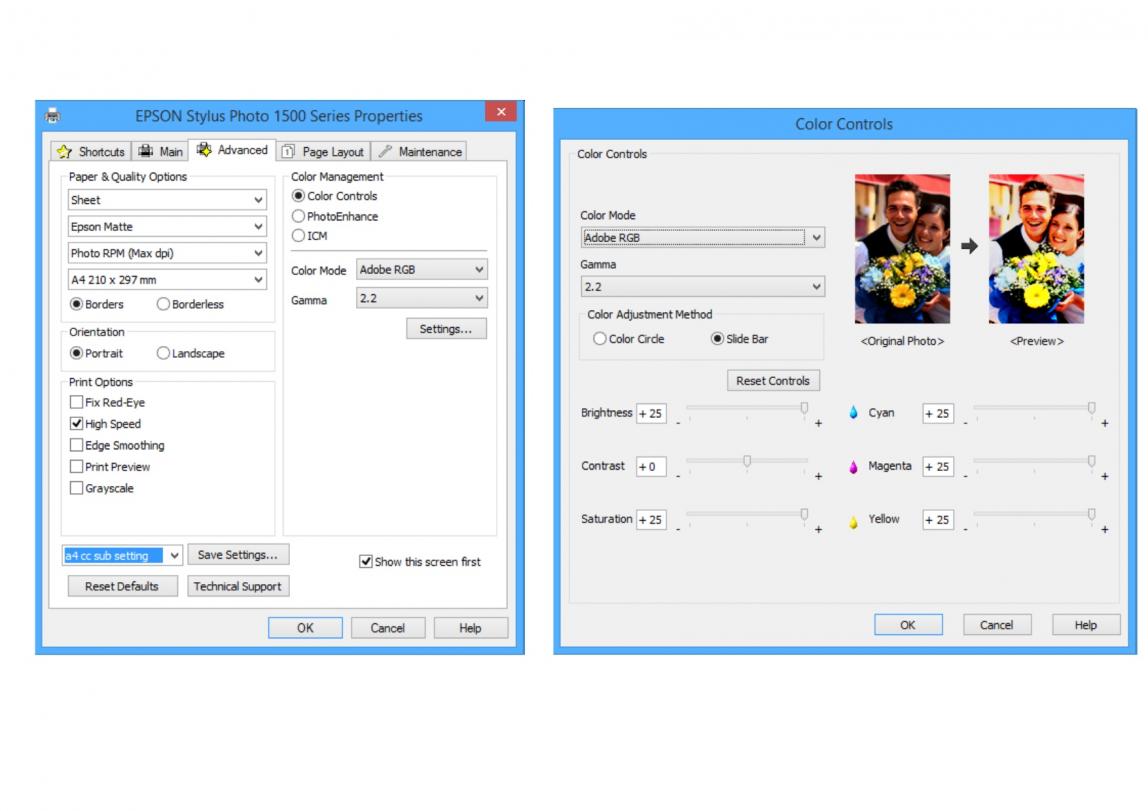

In the meantime, try these settings, to see if they make things better. They are what I used before I had ICC profiles installed, and gave good vivid results and good blacks, printing graphics ( not photos) onto fabric.
Click onto 'settings' on the 'Advanced' tab to open the 'Colour Controls' window.
You can play around with the settings until you get a result you like.
Your design, in photoshop should be set to RGB (Red, Green,Blue) not CMYK.

cheers pw66 i tried a load of settings but nothing so thought id try your settings 100 percent better thank you again i owe you a beer

Your very welcome.philphil123;121071 wrote:cheers pw66 i tried a load of settings but nothing so thought id try your settings 100 percent better thank you again i owe you a beer
Those settings are not a substitute for a good ICC profile, but they served me well when using through 2 litres of ink with a bad ICC profile.
