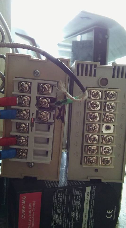

I have an heat press that does not heat up at all.
There is power, the countdown works and the buzzer sounds - but the temp control does nothing.
I have checked all connections, taken out the transformer and put 9volts thru it and the light comes on and all contacts tested, only with a bulb though.
attached are 2 images, one is my controller (wired up)and the replacement showing connections, the other is the front of both - allegedly the same but as you can see there is a marked difference in the connectors - question, can the second connector be used, if so how do I wire it up given my cables !
my controller, apparently is no longer made !!
Any help or advice greatly appreciated guys !

pisquee's question is quite relevant, he is asking for information not offering advice at this stage.. You have 3 sets of connections on the old controller but we cannot see the source for the 2 pairs on the left. I assume the pair on the right is for the heater temp sensor but may be wrong. If you post the pinout of the new controller we should be able to sort out how to connect.
Assuming the controller is just switching 240v then you could connect the heater directly to the mains and see if it heats up. Obviously there will not be any temperature control but at least you can feel if it gets hot.
Do you have a meter ?
Re: Heat press not heating up
I'm not the op.wayupnorth;120544 wrote:pisquee's question is quite relevant, he is asking for information not offering advice at this stage.. You have 3 sets of connections on the old controller but we cannot see the source for the 2 pairs on the left. I assume the pair on the right is for the heater temp sensor but may be wrong. If you post the pinout of the new controller we should be able to sort out how to connect.
I can tell you that on the original controller the two connections on the lower left are the power supply, the two on the upper left are the switched output, and the two on the upper right are the input for the temperature probe.
The issue is that the temperature input could be one of several types, though likely one of two - if these are not the same on the two controllers then there will likely be damage at worst, non function at best.
I know the pinouts for the new controller too, but I wished to check that the two controllers are compatible before offering the information.

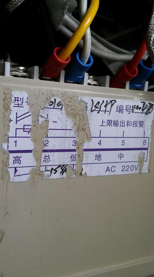

will see if there is anything to id the controllers and post details or images shortly, nothing on fron or rear but there is on the side a label, although it is scratched on the old controller, WillD is correct on the connections, I'll post a better pic to show the colours of the cables, see if that helps, I know the first image is blurred, I'll do a better one, but there is no useful info on the front ;-(

Pic 1 shows the current connectors and colours

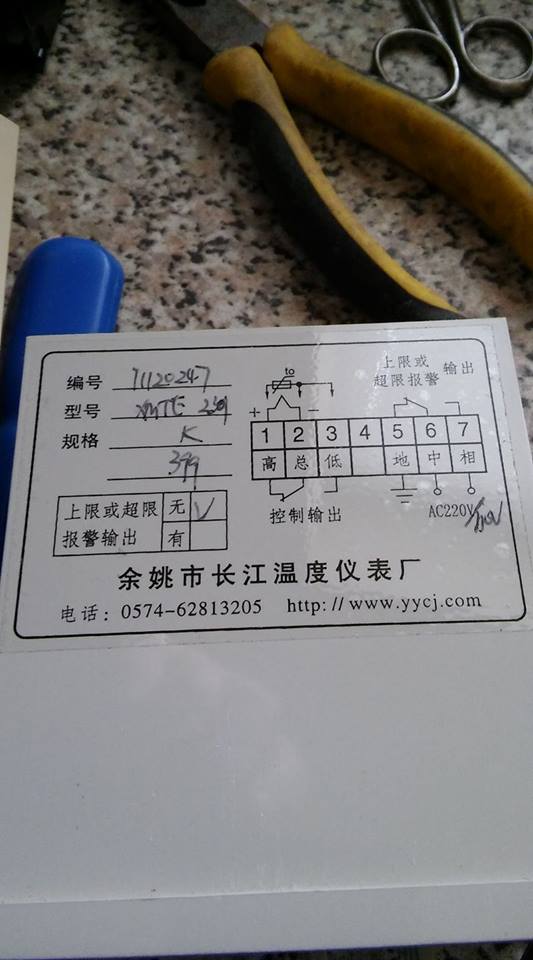

Pic 2 shows current controller and the new one - the number across the top I believe is a licence number ?

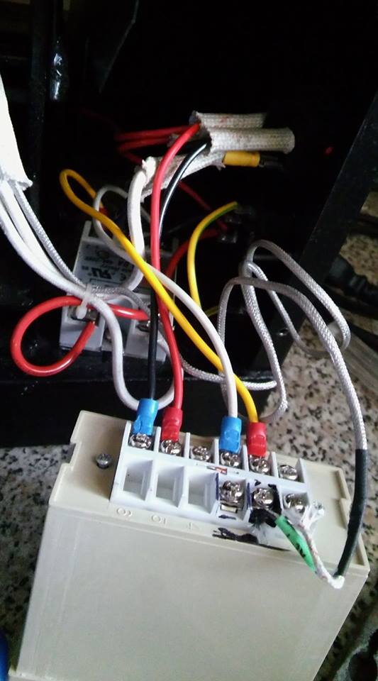

Pic 3 is a label across the side of my current controller, not brilliant as it is scratched !

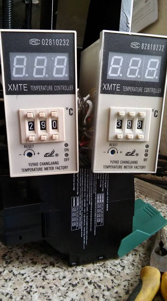

Pic 4 is the new controller - a lot clearer, if you understand it - obviously more connections which is my problem.
Now I'm an old fashioned engineer, and am tempted to send 240 of the finest volts thru the heating element to at least discount that as being the problem, the reason I doubt it is that neither the transformer (SSR) light comes on, nor does the controller, I am making the assumption that at least one of these might show signs of life if any current was getting as far as the platen !
