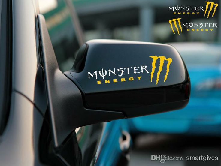

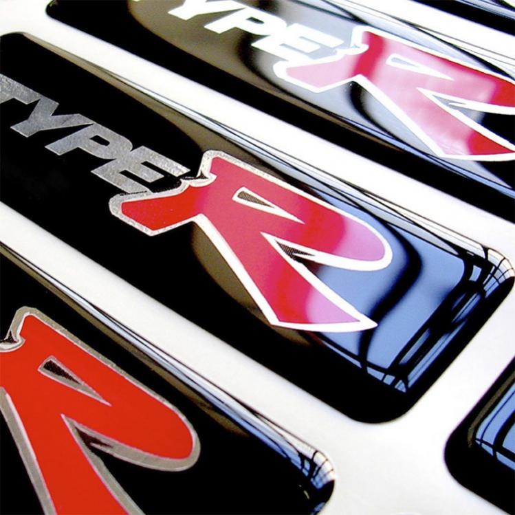

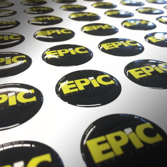

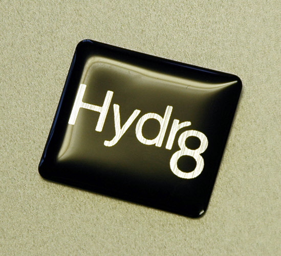

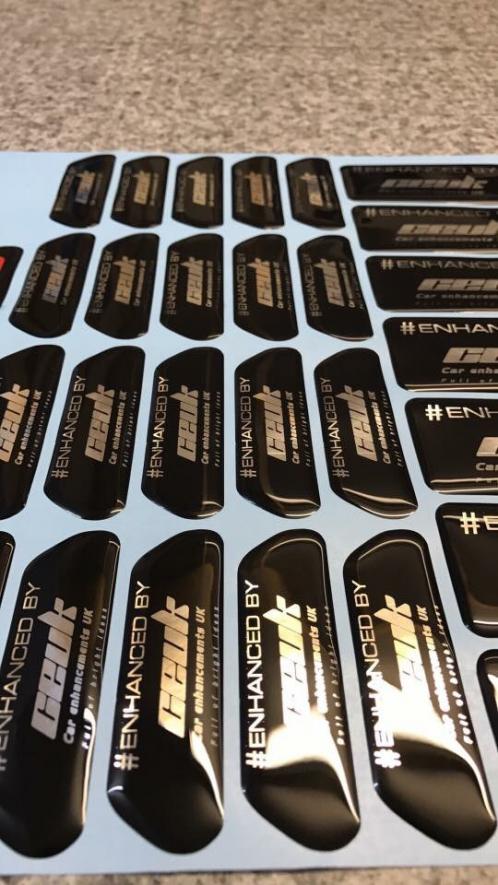

I currently have a Canon IX6850 inkjet printer which does not print vinyl I have tried many types of media inc Photo paper and the results don't appear to be good, I have also been informed this is due to my printer being water based.
I would like to create domed/resin badges, decals, vinyl stickers for mainly outdoor use but some interior, I also occasionally print of technical plans due to my profession. The speed for me is not essential as I do not have a huge client base on average 30-40 orders a week as the business is fairly new hence why I was considering the Roland BN-20.
I have also attached some images of the types of products I would like to produce.
All information would be helpful,
Thank You
Thank You
