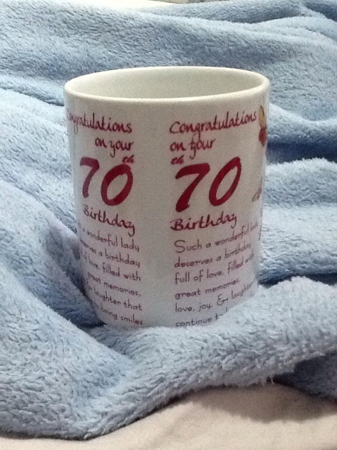

Here's a pic she sent of it, as you see it's not a subtle fault, which is why I'm blown away if it was missed at both the pressing and packing stages.

Not sure about the pink hue - but isn't the "th" on the "70" (right hand side) in the wrong place?
Re: Bemused by strange hue on a Mug
John G;118038 wrote:Not sure about the pink hue - but isn't the "th" on the "70" (right hand side) in the wrong place?
That was the first thing that caught my eye too John! Probably one of the reasons I never show my own work in the forum!
Ha yes it is. Oddly never mentioned by a customer though........ actually, not quite true, the lady with the pink hue brought it up although she did say that wasn't the issue lol!
It's been changed now. We do several of these designs and typically this is the only one it's like this. Wife says put it down to "artistic licence for balance" ..... whatever that means

I reckon you've kept it in the press too long. I have a design with thick black text and a block of yellow; the yellow often bleeds up to the top as the press is timed for the heavy black.
