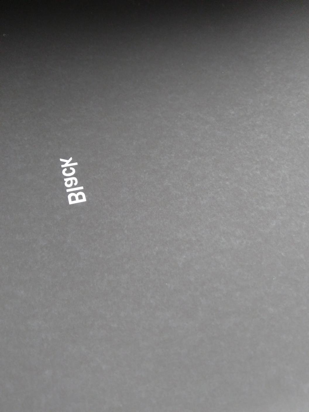

I am using a Ricoh 3110 with in-date Sublijet-R ink on TexPrint-R paper. I am getting a kind of mottled effect on the printout and i am wondering if this is normal or not? I have nothing to compare it to so would be interested to hear if anybody else has the same.
This is a sheet of black printed out using the PowerDriver Print Primary Colour feature. So what do you think, does this look normal?

Difficult to see on my laptop screen but mottling could be down to too much ink. I don't use that paper personally but it should be very good and not cause these issues.
Obvious question first, is the paper the right way around? I assume you've been through all settings compared to support site on Sawgrass...go over them a second time just in case.
Has the printer been working ok previously?

Yep, printer was working fine since I got it (3 years +). I'm not 100% sure when it started but I did recently replace the ink as the old ones were over a year out of date. One theory is that the printer has been damaged because of this.
Paper is the right way round as the TexPrint-R has a logo on the reverse site. I also have a pack of TruPix which also exhibits the exact same problem.
I agree with it looking like it is printing too much ink but not sure if this is something I can change in printer settings?

Have you pressed it? Does it show on the presses item?
Re: Ricoh 3110 printout looks mottled, does this look normal?
Yes, it shows up on the printed item.
I am having major issues with my end product mugs currently so am trying to start at the top (Printer) and work my way down with troubleshooting!
Just having nothing to compare it to makes it difficult. I am going to post these off to my supplier tomorrow to get confirmation from them that it is normal and I might get them to print me the same out on their system and send it back to me.

How about printing the image through a normal printer with normal ink. It could be the image or your settings.

The image is being printed using the PowerDriver 'Print Primaries' function, this prints the image only using black (K) cartridge. I am assuming we can rule out the image being the issue by printing in this way?

Made some progress today. I am printing using the ICC profile from SawGrass instead of the PowerDriver, I changed the paper type to 'Glossy' even though all of the setup guides tell you to choose 'Inkjet Plain Paper'.
Although it takes an age to print it has resolved the mottled look on the paper.
Very strange, anyone using Glossy instead of Inkjet Plain in their settings?
