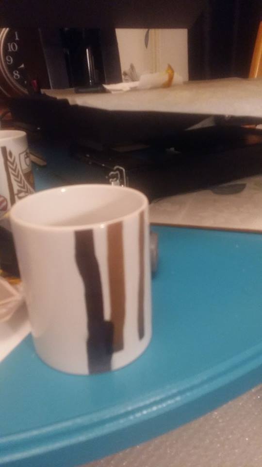

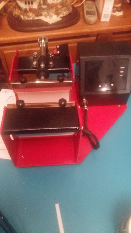

Just try 170 temp and 120 seconds see if that helps any.... (What press are you using?) drop a picture up of a pressed mug..

Thats the press we use and the mug we are playing around with, the darker line might look black but its brown. but it is darker than we have had before.
