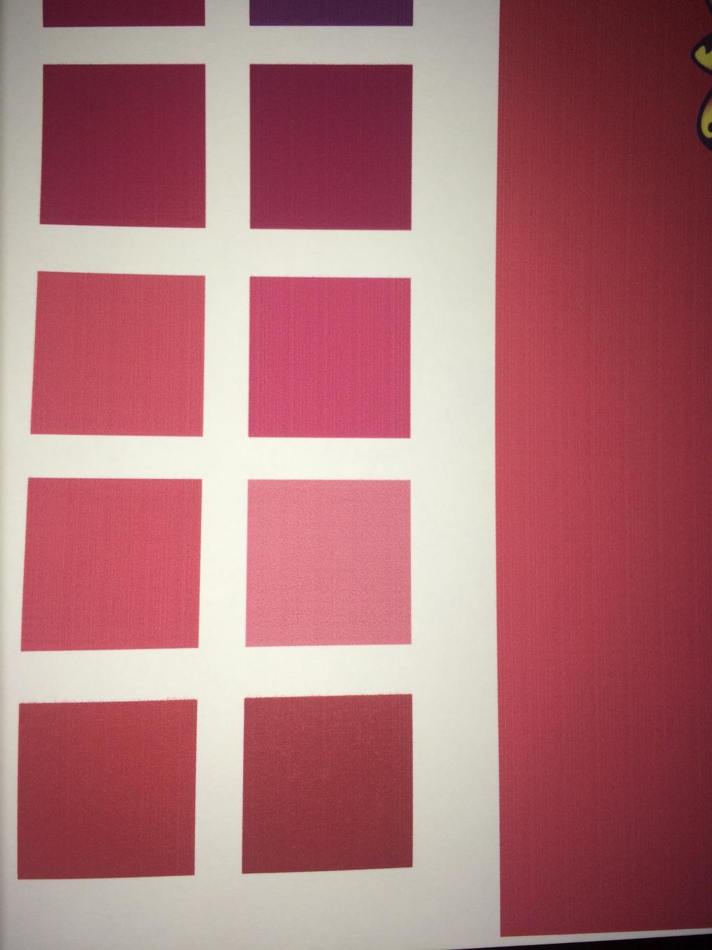

however, now another issue has appeared... there are small lines across the designs when printing any shade of red :frown: (edit - photo added) i printed the same design onto the sample paper i received and the lines do not appear, so it seems the paper is the issue this time. anyone any advice on this issue?! it seems like i am getting nowhere, just going round in circles :confused:

the banding looks like its an ink issue, the ricoh is very sensitive to the ink and if the ink is too thin it wil cause this issue. In the past many suppiers say they have ricoh gel ink when infact they rebadge epson inks and sell as ricoh. Ive seen inktec inks rebranded as ricoh inks which is complete tosh. Ricoh inks are around 2.5 to 3 x more vicose than Epson inks so are designed to sit more on the surface of the paper than epson inks do. If you use a thinner ink the head starts to dry and the ink will not flow as fast due the the lack of viscosity giving issues like banding .

mags1892;116551 wrote:the banding looks like its an ink issue, the ricoh is very sensitive to the ink and if the ink is too thin it wil cause this issue. In the past many suppiers say they have ricoh gel ink when infact they rebadge epson inks and sell as ricoh. Ive seen inktec inks rebranded as ricoh inks which is complete tosh. Ricoh inks are around 2.5 to 3 x more vicose than Epson inks so are designed to sit more on the surface of the paper than epson inks do. If you use a thinner ink the head starts to dry and the ink will not flow as fast due the the lack of viscosity giving issues like banding .
thanks Mags. I've thought all along it was the ink, just really needed to be sure. The seller won't admit it's their product's fault, of course, but I will continue to hound them!!
I also wondered if it was the printer, but it's perfectly fine other than these lines!!
thanks :redface:

Been there when we were developing ricoh ink we first started with epson formula and had the same issue with some 3110s . So we bought sawgras inks and tested the viscosity and redeveloped our inks to be around the same viscosity but trying to keep some f the benefits of the other inks like cleaning agents and binding agents etc. Took us a long time ti develop but we now have a very nice ink.
