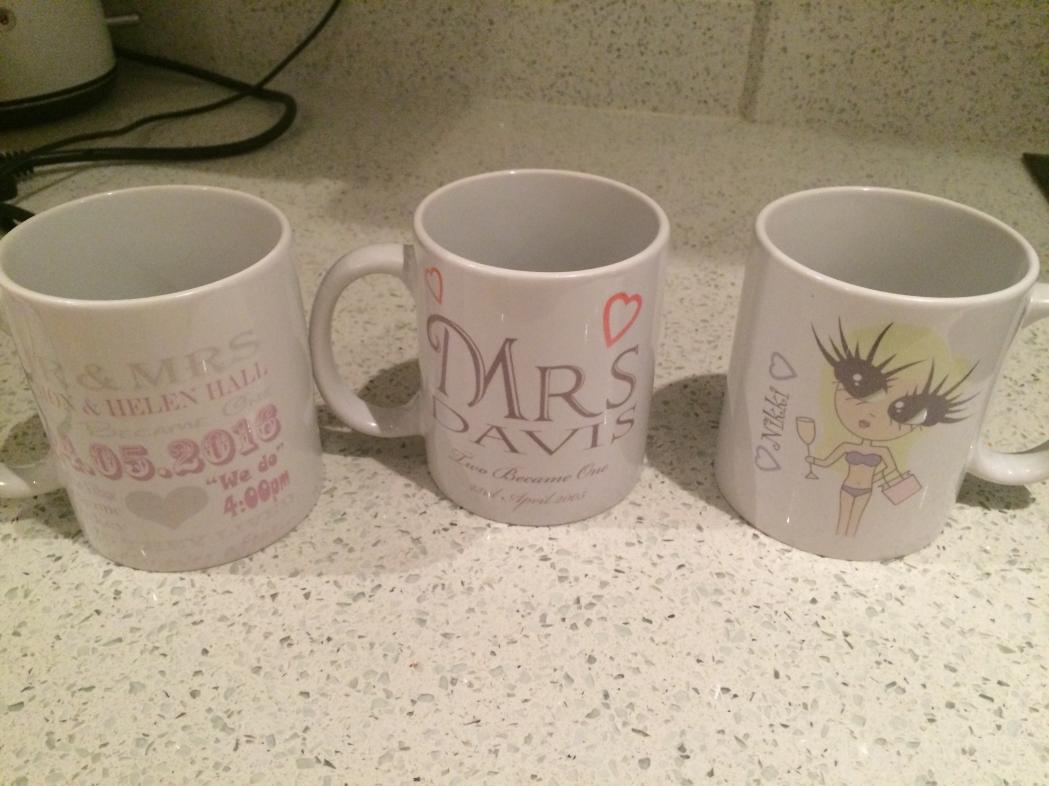

Re: Print not transferring to mugs
Thanks Paul. Checked in printing on right side of paper and set it at 180/320 seconds. This is the result I got, the mug on the right. It's come out no different to the one on the left that was printed for a lot less time
. The pressure was set just so I needed a bit of force to close so not too hard. Have no idea what else I can try.
