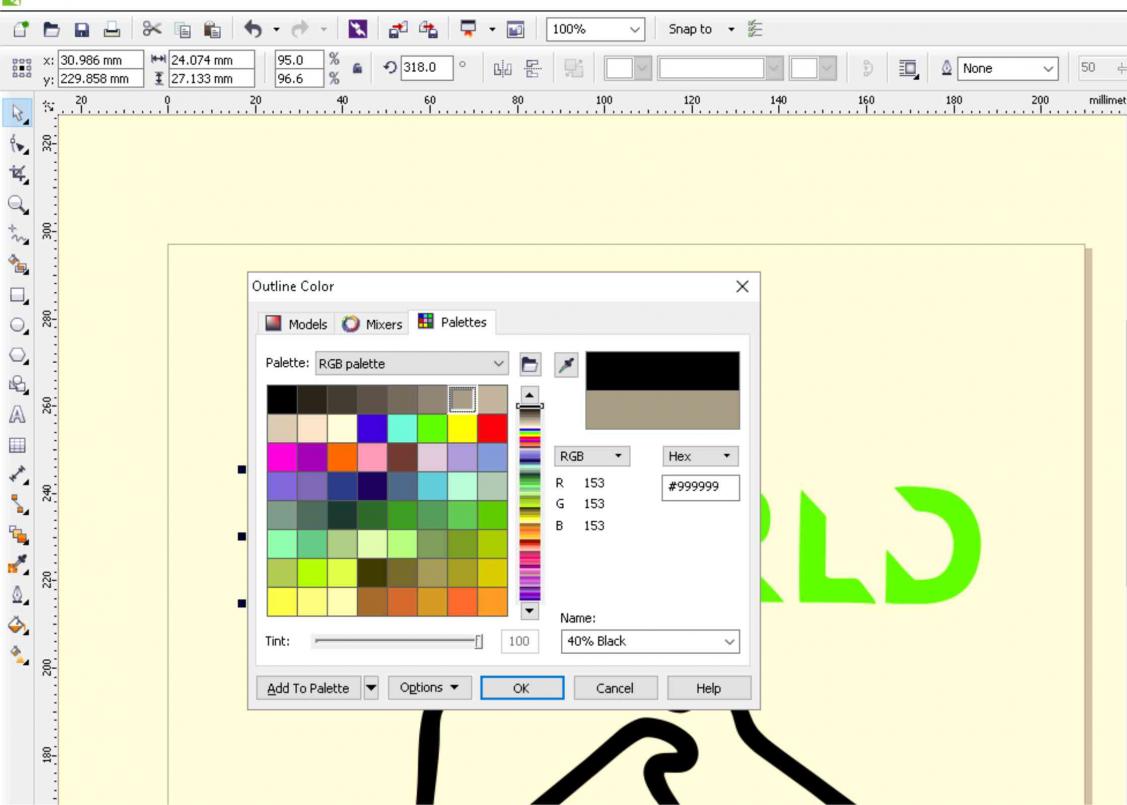

anyone know what i must have pressed to have this happen, all of my colours have changed, there is no white anymore, just this odd cream colour, and of course its making all my colours look odd ? the one highlighted under the black is grey !!

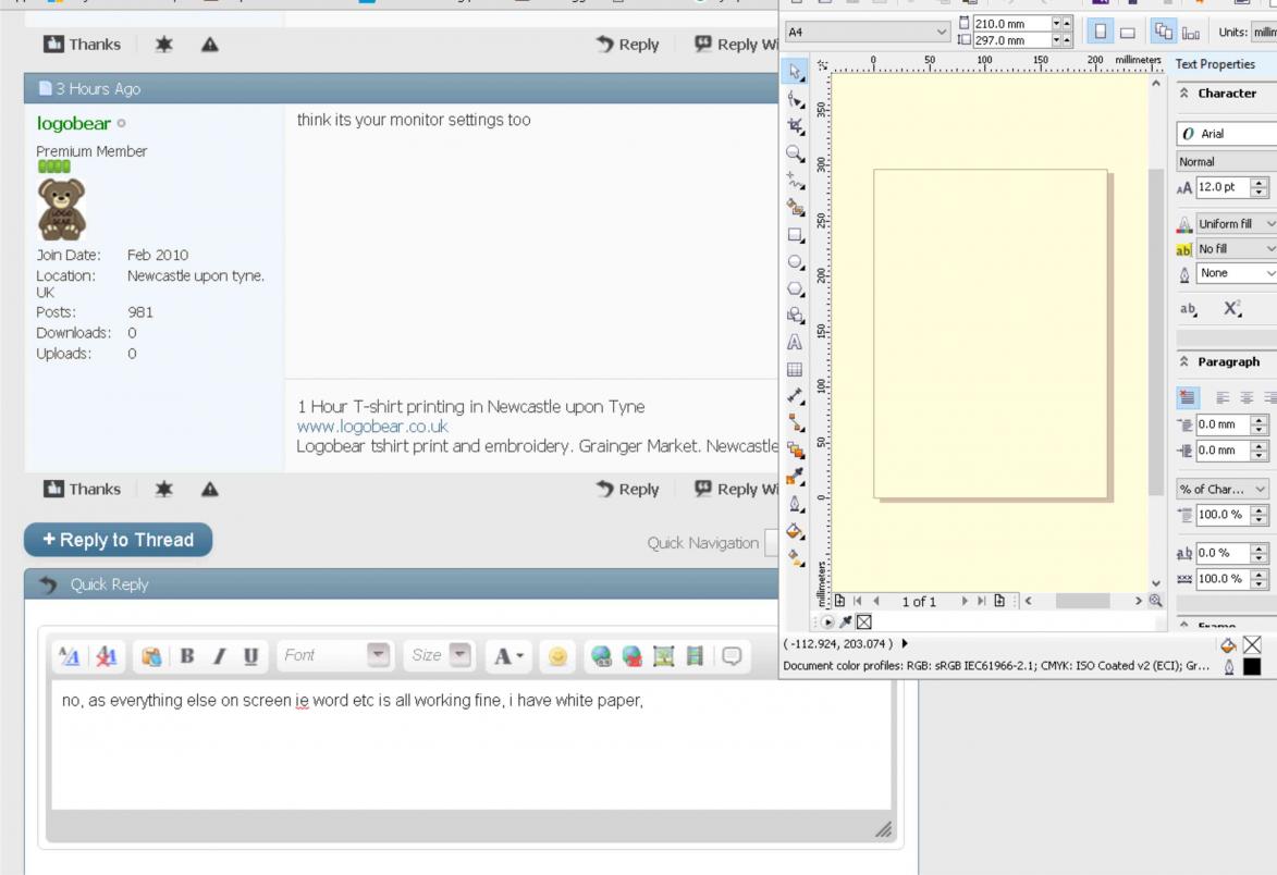

no, as everything else on screen ie word etc is all working fine, i have white paper,
see attached photo,

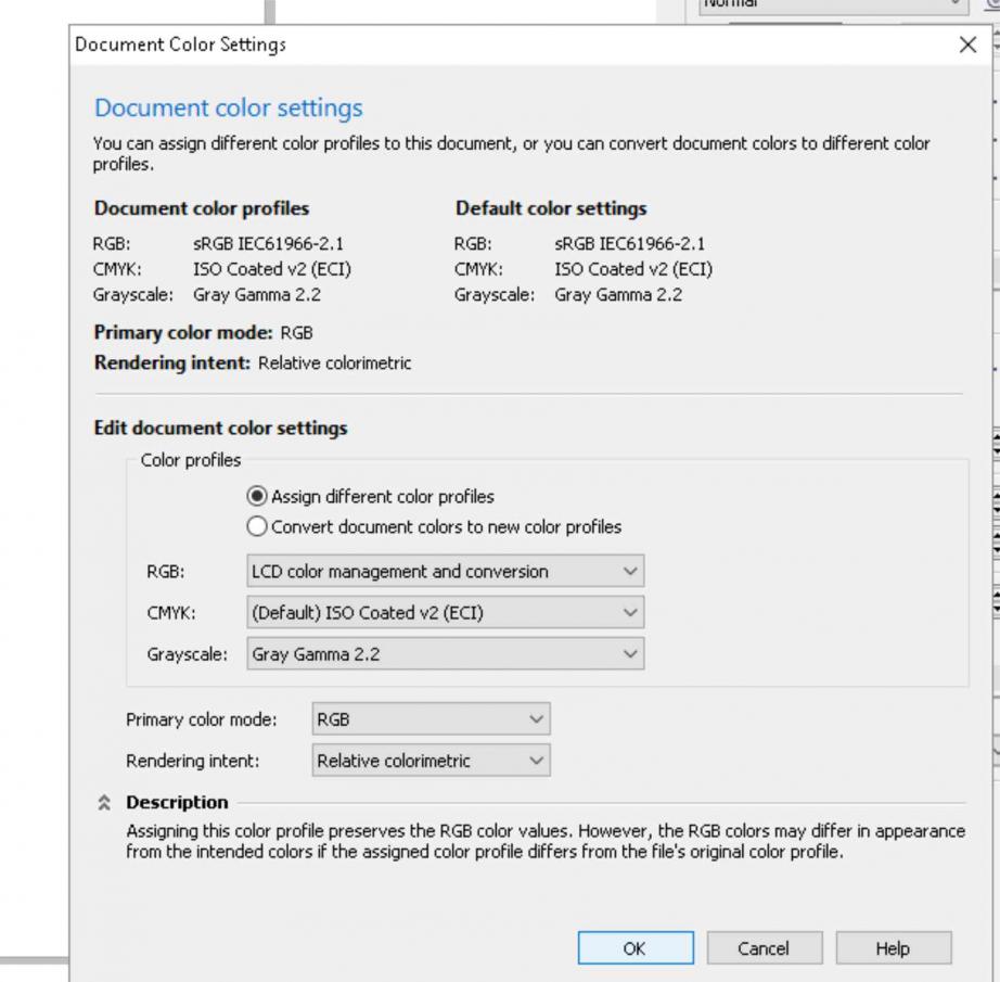

seems its quite common, i now have it back, but i am no longer on default settings, i have changed the RGB setting no idea if this will now affect anything else, just a waiting game lol
