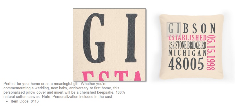

I see all over the place websites selling personalised printed items, like the cushion cover below, on cotton canvas and sometimes 100% cotton t-shirts. I can't imagine they are doing these in bulk like screen printing or something like that as the designs are personalised with names and dates.
vB_ID:3953
vB_ID:3953
cotton canvas pillow case.jpg (66.82 KiB) Viewed 114 times
So I am wondering if you knew how this might be achieved? Is there any sort of desktop type hardware which can achieve this? I have seen things like DTG which priced into the £1000's which is not viable for me at the moment.

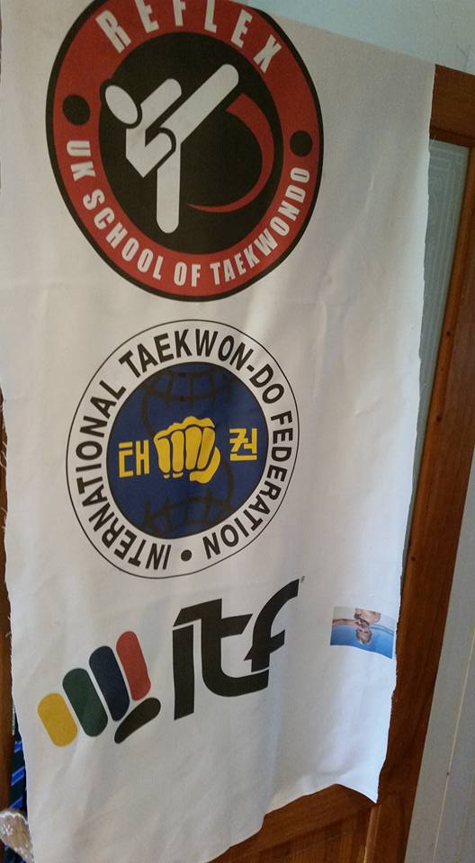

As Ink is one of my specialist subjects i did this asa test for table cloths, This is on 100% cotton printed on a wide format epson 9880 using a special pigment ink. You need to have a treated cotton and a pigment ink with a very high pigment content and binding agent. Then you need to heat normally through a tunnel dryer but you can HOVER a heat press ideally you dont want contact as it will flatten any fibers.
