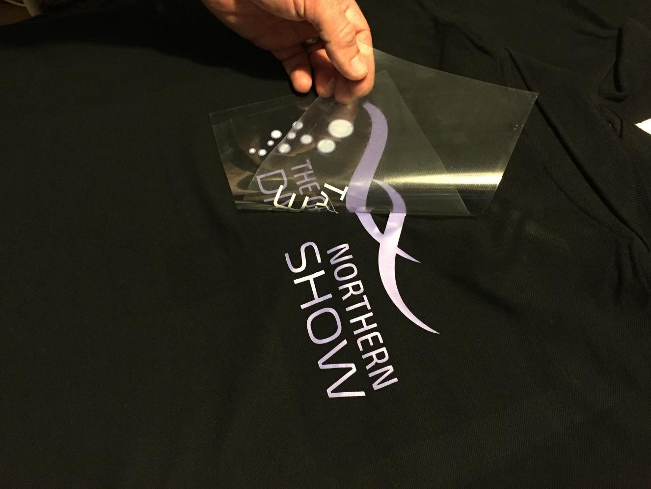

We have a BN20 and are printing and cutting the logos on this. Each logo is three colour or full colour, some include white and we've been using Magic Touch's Soldark. The whole process of printing, cutting, applying app tape and weeding has taken forever (several days), with many bits of logo coming off and being lost along the way. Then, when pressing we've been getting mixed results and lost a few polos (see pic).

If it's coming off after pressing; I had a similar problem with Siser PU print vinyl at first, you might not be pressing hard enough. After my efforts failed I called my supplier and they advised that what I thought was hard pressure was more like medium so give it a try....really crank it down and fingers crossed.
