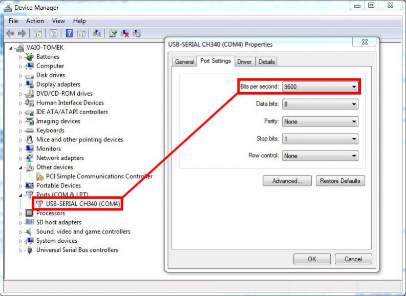

That was my mistake even, that lot's of manuals show to set up plotter that way. It's a wrong way. I knew that I've made mistake somewhere, but I didn't know where. Than I checked everything AGAIN, step by step, starting from USB drivers installation. That's how I realized, that plotter should be set up on a COM port only (it doesn't matter if it's COM1, 2, 3, 4 or whatever number it is). There is no need to add plotter as a printing device. Next thing you should check (especially if you use SignCut Pro) is the connection speed on your COM port in Device Manager (check the screen - the default speed is 9600kbps which is absolutely enough).

If in your SignCut cutter settings you have option "Use Windows serial setting" checked, but your plotter doesn't want to cooperate, don't throw it away yet, just uncheck this option, set up connection speed manually and everything should be fine now :)
