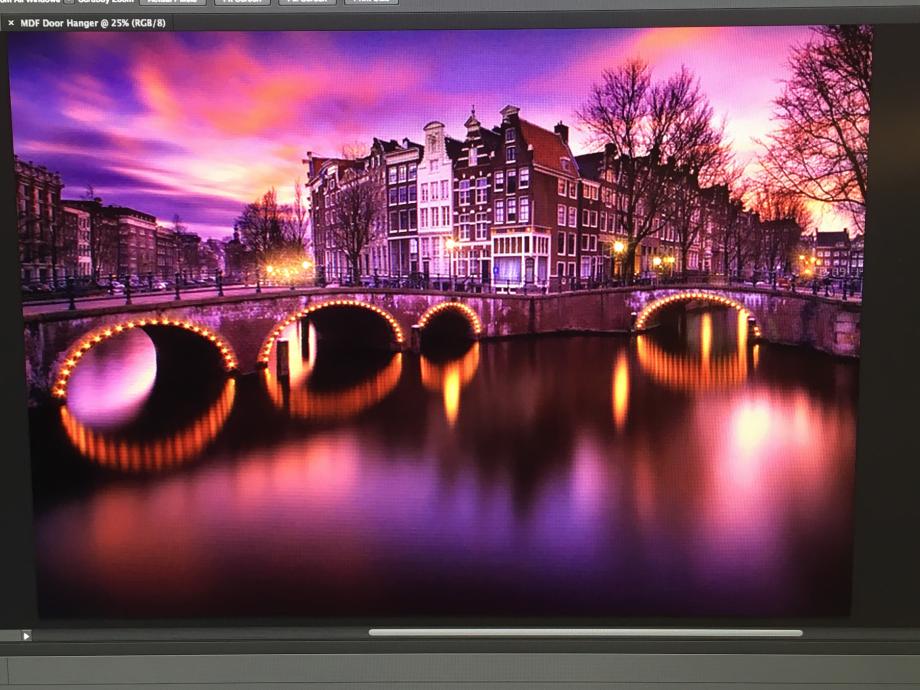

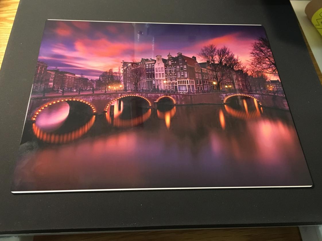

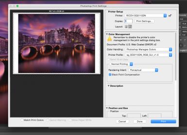

Hi guys, i have just printed a HD photo on to HD metal using sublimation but i am not totally convinced my color settings are correct or i am using the correct settings. I am using a Ricoh 3110 sub printer with sublet r cartridgesI use photoshop with the ricoh ICC profile installed on MacI kept the color mode to RGB modeFlattened layersI selected print and let photoshop manage colours, is this right?Do i keep the document in RGB mode or CMYK to print?Do i select photoshop manage colours or select the printer manages colours?Print options selectedImage in RGB on screenImage pressed but colours not vibrant

The Ricoh printer driver will expect RGB data, so stay in RGB for the whole workflow - the document settings your have in that print dialog show you are using a CMYK (US coated) document workspace profile, you should be using Adobe RGB 1998. This will affect your colours somewhat.
The other thing to note, is that if you haven't profiled your screen, then you have no way of knowing if the colours on your screen are true, and so equally no way of knowing what is going to come out of your printer, and whether it is printing correct.
I'm also assuming that your printer ICC is just the generic one from Sawgrass, and not one you've had made specifically for your printer - this will also help if you get it done.

image you picked for this project its truly beautiful for human eye. but... human eye spectrum is much higher then your printer and inks in your printer.
No matter if you use HD metal or super hyper HD metal. it just wont work.
Look in to your image bit closer. what can you see? LOADS of gradients and nice, vivid colours. your printer cannot mix 4 cmyk inks to achive them like your screen show them to you.
So now look on your screen shot of photoshop printing window.
can you see rendering intent set to perceptual?

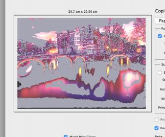

so this image that can bee seen by your printer (icc) like this: All greyed out area is shows colours that WILL not be able to reproduce the way you want it. simply as ink spectrum is much lower then human eyes and brain. so now here comes the rendering intent.
Perceptual intent will take ALL the colours from greyed out area and TRY to reproduce them to the closest match possible. in most cases it works really well. but in case of image like this your hd metal is best as it can be.

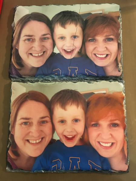

Thanks for that Paul and very interesting indeed but I still may have a silly question, does this mean that we cannot reproduce HD images via sublimation? Or how do I get as close to it as possible? I sit on the edge of my chair every time waiting to see what's going to look wrong! I done a photo slate last night and the ladies gingerish hair came out orange.
this is the original image Then sublimated it to slate, it was ok but it cracked on cooling so I thought I'd up the colour a little but this happened. I just want to print high colour images onto various sublimated surfaces so please give me simple tips to save these errors. #printingnewbie

You clearly altered image so this is why is diferent on both slates. Also you need to stick to corect times and temps to be sure you not burning ink.
