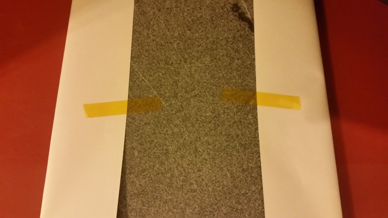

Its the tape on the image. I put the paper with the image on the slate then put the tape on the image paper then pull it onto the back of the slate. The tape marks are coming onto the image itself.
Re: Slates
Posted: 20 Dec 2015, 16:52
by wayupnorth
No need to put the tape anywhere near the image:
vB_ID:3788
vB_ID:3788
vB_ID:3788
vB_ID:3788

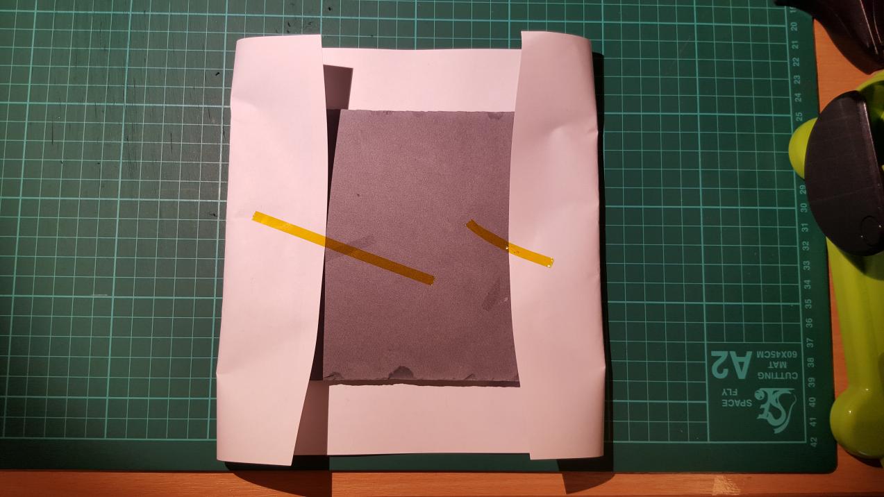

Why do you need to put tape onto the image:confused:
I have just done a few so took a picture of mine!
vB_ID:3789
vB_ID:3789
2015-12-20 17.58.48.jpg (97 KiB) Viewed 249 times
Re: Slates
Posted: 20 Dec 2015, 18:14
by Mugshots
Ah yes. I understand now. Im not leaving enough blank paper round the edge! Nice one. Thanks very much
