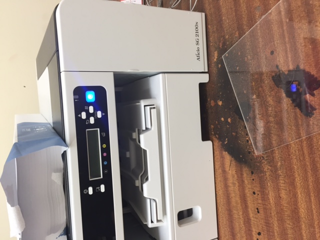

Hi everyone I'm new on here and new to sublimation printing on mugs and like most, I'm not getting it right at all. I need help.
This is my printer

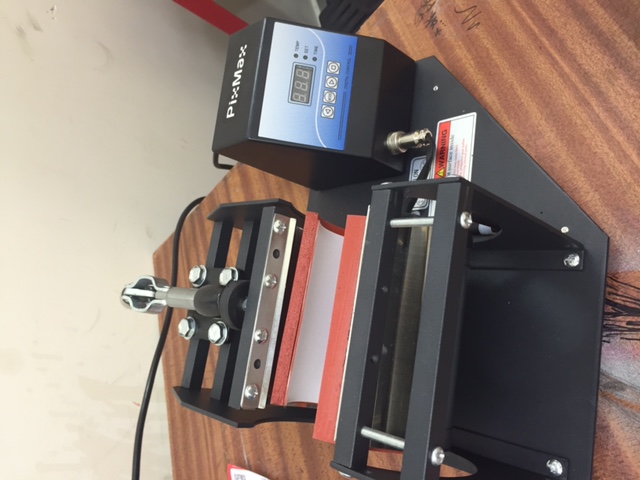

this is my press

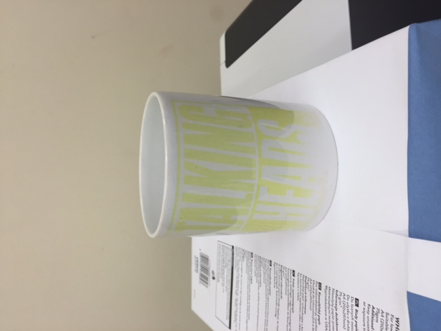

these are the results i'm getting

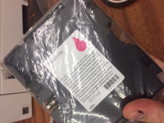

I've read a few things on the net about why this is happening ie times, paper I'm using etc. I did use the original ink that came with the printer which are these cartridges
vB_ID:3776
vB_ID:3776
and then I installed the sublimation cartridges. Maybe the old ink is still in there and needs flushing out?

What's your temp and times?
I used 180 deg for 180 sec. When I put a mug in the temp drops so I wait until it's back to 180 then start the timer.

Yeah I've more or less tried every suggested time and none have worked. I either get a faint outline of the image which just rubs off or this yellowy burnt image which I've photoed there.

I could be wrong but judging by what's on the printer I would say you are using standard bond paper and not paper specific to sublimation.
Also do you know if the ink cartridges are sublimation based?

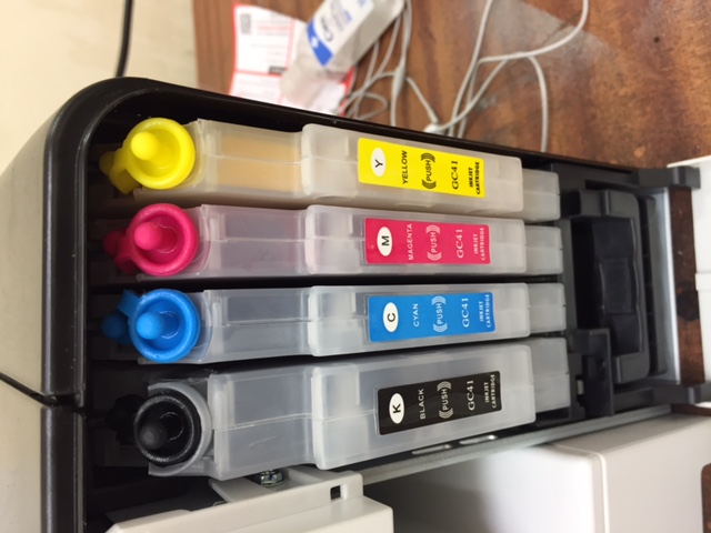

Ah no I'm using sublimation paper. I got that with the press along with the mugs
vB_ID:3777
vB_ID:3777
these are my sub inks loaded
Re: What am I doing wrong?!
Just need to buy sublimation ink and you good to go. This is standard ink by the look of it.

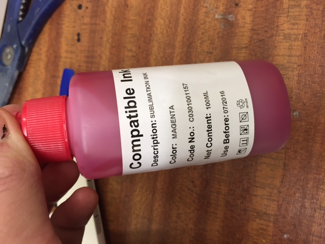

vB_ID:3778
vB_ID:3778
Hers's the ink the cartridges are filled with. It is sublimation ink

If you has standard inks in, then as you say they may need more time to flush then out, as a noob myself I couldn't say how you tell when this has happened though, bought mine as a lot and installed the dyesub inks from the outset. I do know the initial fill takes what seems 25% of the cartridge
