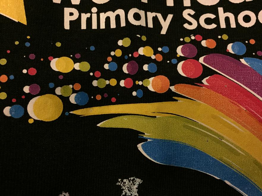

I will post a photo later. It doesn't help that I have a different model of OKI colour printer (C841)

I don't have any issues with image quality.. just the alignment..

been out all afternoon just back.
so is it out of alignment left to right or top to bottom can't tell which way you printed that from that little bit of the image.
