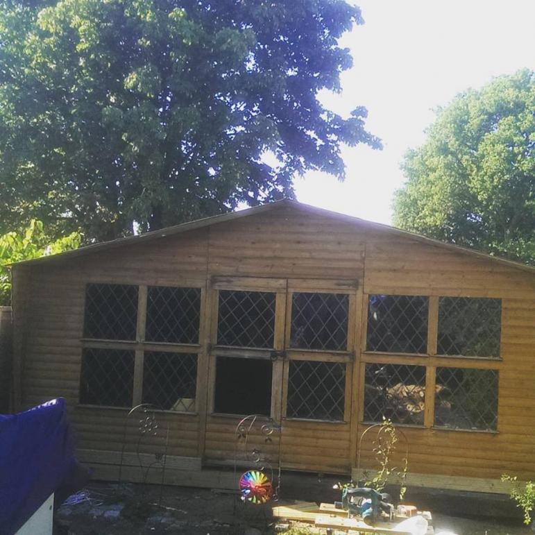

Quinsfan
Posts: 1213
Joined: 13 Nov 2013, 15:50
Re: Wiring my summer house
Post by Quinsfan »
Here is my erection!!!
vB_ID:3651
vB_ID:3651
