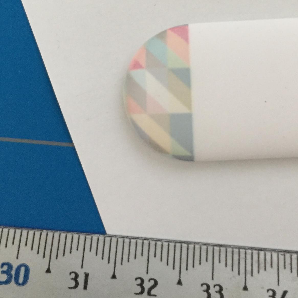

I'm trying to sublimate on a soft polymer (fluorelastomer). It's not an official sublimation blank, but an untreated product. However it seems to sublimate, although the output is very light at this point. So far I've tried the Sawgrass advised setting of 195C for 70 seconds.
The product hold fine under this temperature, no deformation and no decoloration.
Can anyone advise me on what to try next? Should I increase the temperature, timing, pressure or should I think about changing the color profile settings?

So far I've tried 2,5min @ 195C, 4min @ 195C and 2,5min at 205C. All with little improvement. See picture from left to right.
Would changing the pressure be an option?
