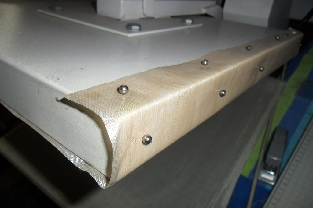

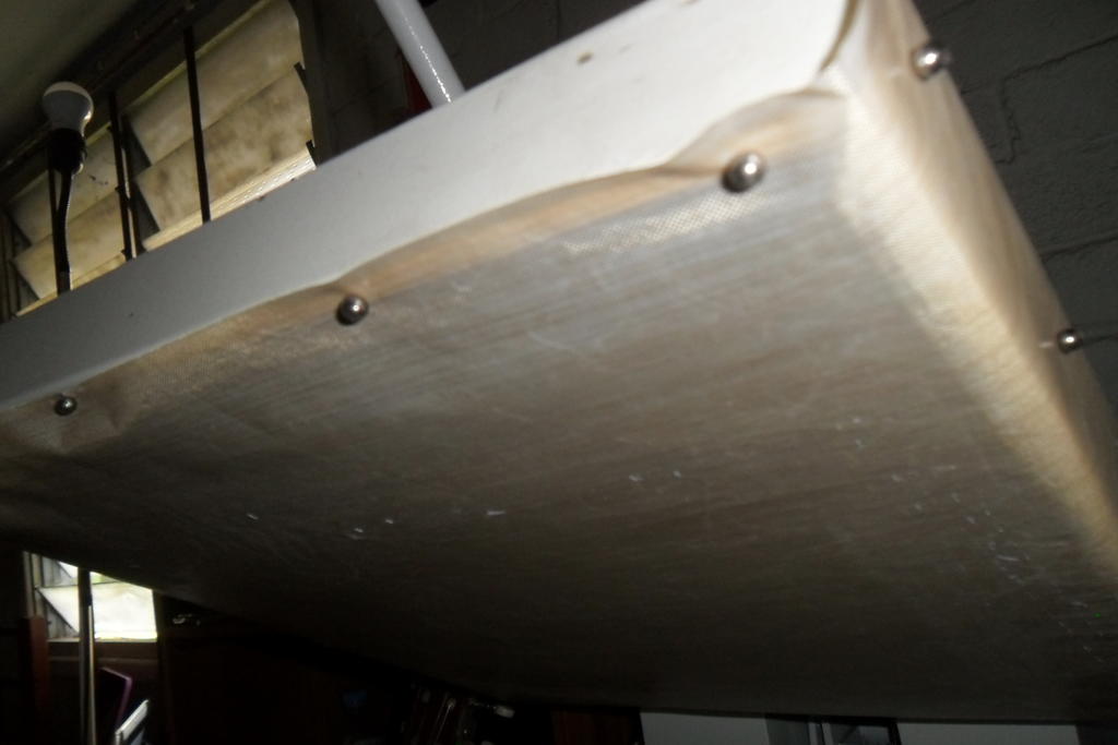

That reminds me that I still haven't posted the promised pics of using my balls to hold teflon sheets on my flat presses.
I can't find the thread about using teflon sheets on presses so I'll post it here anyway.
I don;t use my balls any more. I got some thin neodymium strip magnets. The neodymium balls were just the only strong magnets I had back then.
The strips work better on my big INSTA press.
Just saves putting a teflon sheet in place each time. On the bottom platen I just wrap the teflon under the rubber mat. Except the INSTA, where I keep it in place with drawing pins thorugh the sides of the mat.

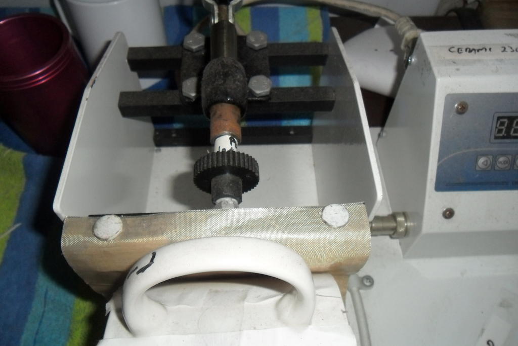

I do the same on my mug presses. Instead of using a piece of paper to prevent bleed through to the element, I use magnets to hold a teflon sheet in place. Easily removed for occasional cleaning, but never seems to need it.
