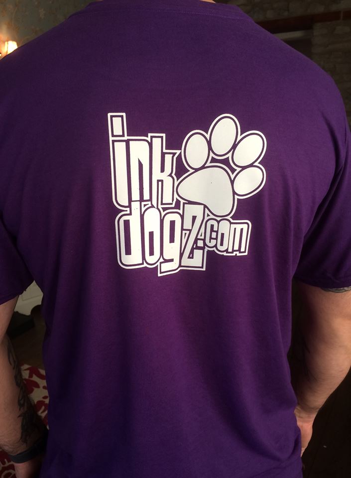

Today i printed this using the SUNANGEL WHITE printer and when i peeled it off i flipped over and did the same on the breast, i never put them over the platen just straight on the press.

Dave that looks great. What heat press do you use ?. I'm convinced my lack of success with with my SunAngel and also TMT TTC3.1 papers is my heat press. Though it is great with Sublimation.
