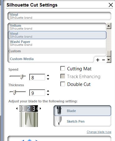

For MDP vinyl i use speed 8 thickness 9 and blade 2 as on the software and never have a problem (no mat)

Bob700;101211 wrote:I've finally got it cutting on the correct settings, blade 1, speed 8 and thickness 4 but it seems to miss parts
you need to up the thickness to 9
see post above use the studio setting that they provide, thats what they are there for if you click on the media it will give you the settings that you should match your machine to.
If you dont use the silhouette cut setting, it doesnt matter what you set anything to it wont cut right.
