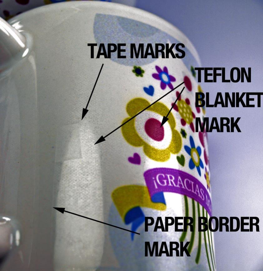

Hello everybody here in this forum, searching the web i found you, and well i like to share a problem i recently had
(first i am from south america - Venezuela - and really excuse me for grammar errors, i read very well but write like a 2 years old child)

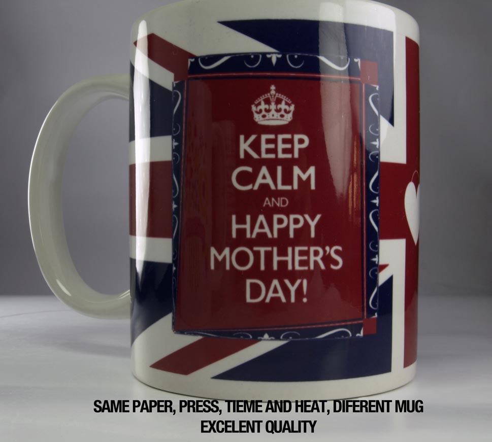

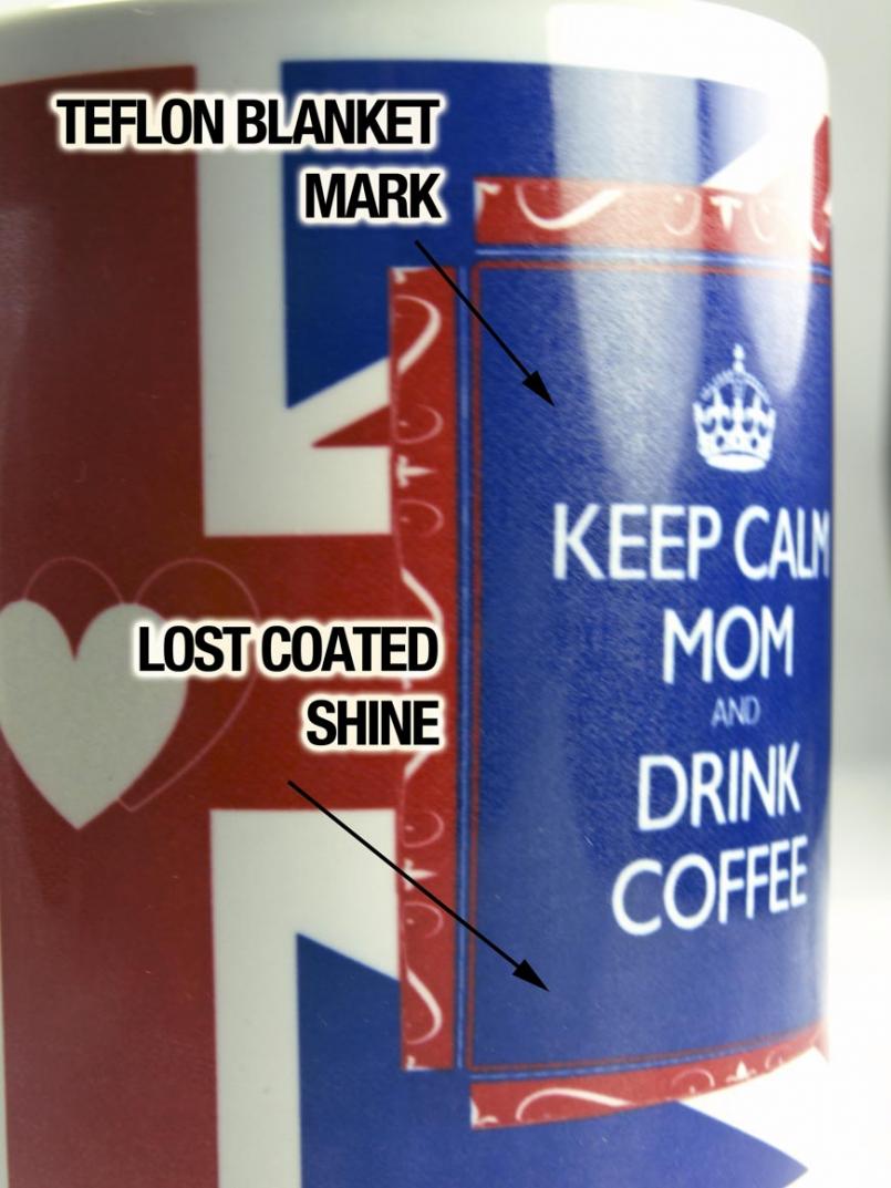

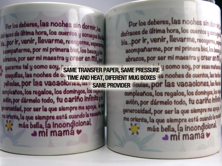

well this is the problem: My wife and i started this project and were doing well, i am graphic designer and art graphics specialized for 25 years, but once a mug box finish and start other begin this problem, i think the mug quality (thin coated finish) is poor and if this it, there is way to avoid this issue?
1- I will try lower the pressure and heat (actually 395F and 180 secs, 300F min, we insert the mug when reach 460F, low the temp and rise again)
2- Wrap another paper to protect the print paper
3- Low the time too to 160 secs
I wonder if anyone in this forum has experienced the same problem and if you could really have a solution to avoid wasting 30 mugs.
What i did try:
Change the transfer paper, same result
Change pressure (lower and upper), same result
Change time and heat (lower and riser), same result

Re: Bad transfer, teflon blanket marks on mug, sticky paper, tape marks
First thing I'd do would be try different mug suppliers. You show one mug is perfect whilst another is poor, looks like poor quality mugs imo. Also, a known brand if paper would help. Make sure you're using good heat tape but I think your problems could be the mug coating.
We can't help with the inks you've mentioned due to Sawgrass licence restrictions but this could well be contributing to your problems as well.
