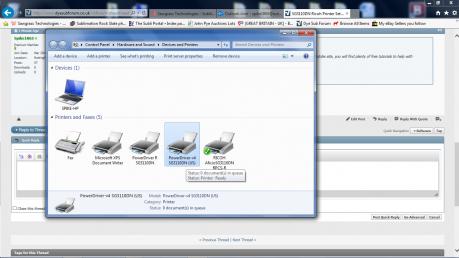

I have these 2. Which do I set as default now?

Sorry, that's not very clear.
One is called PowerDriver-R - sg3110dn
The other is called PowerDriver-R - sg3110dn v4, (US)
Is it better to use the v4 US version?
rgds
spike
rgds
spike
Re: SG3110DN Ricoh Printer Setup
Hi spike I only have the one PowerDriver, but I would say go with the V4 as that is the latest version number for the PowerDriver.
