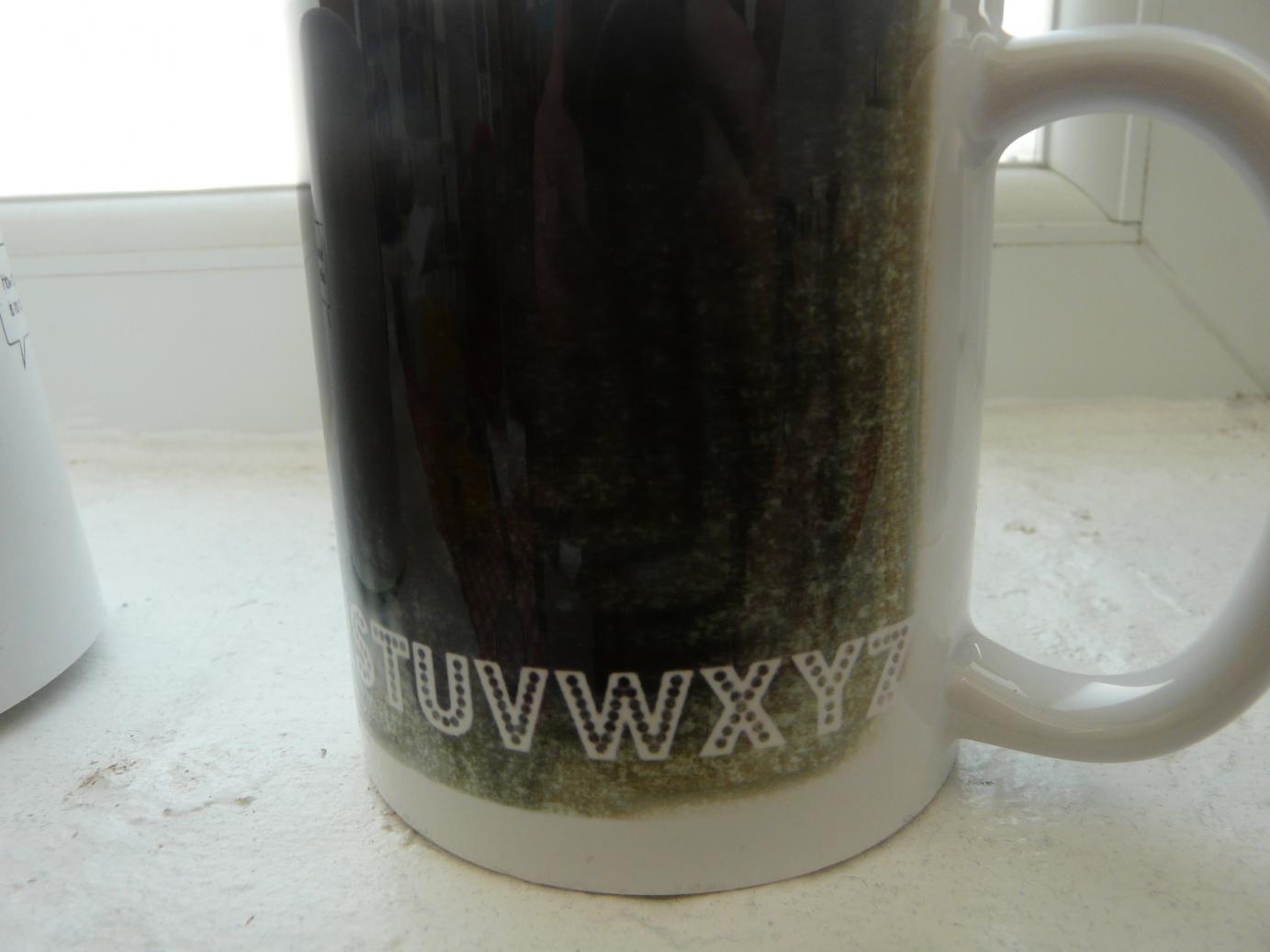

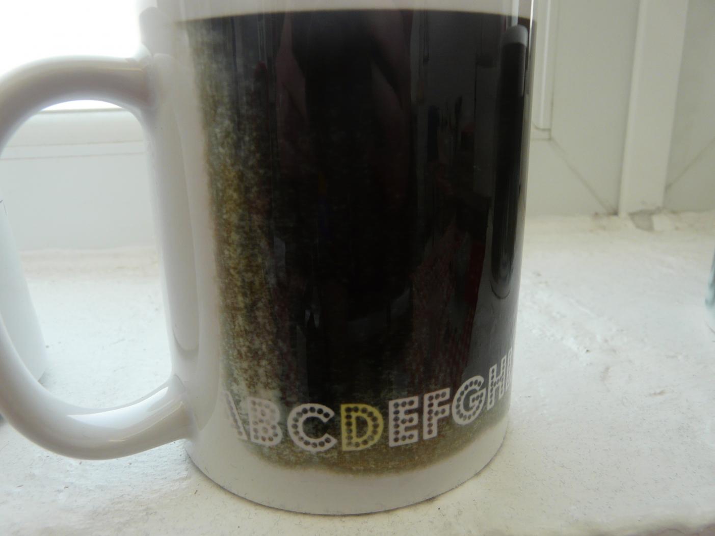

I recently bought a Studio Mug Press from Xpres, which is working fine but I do seem to have problems when doing full mug printing whereby the image goes from top to bottom of the mug. I was told that the press is able to do this but I'm finding that at the very top of the image, at the edge of the mug, there is sometimes some bleed from the colour and the print it distorted/dotty at the very top. Also at the bottom there is sometimes a problem with solid colours looking a bit faded in places.
I understand that because the thickness of the mugs at the top and bottom, it is tricky to get this right but I've seen some brilliant examples of full printing from top to bottom.
Temp: 180 degrees
Time: 180 seconds
^^in line with manufacturer's guide
Could anyone offer any advice on this?

Flipping can be useful where blankets/mugs are less than perfect but you shouldn't be having these issues. have you spoken to Xpres tech. support for their advice? Overlapping shouldn't cause a problem other than possible blow out under the mug. What pressure are you using? Maybe post a couple of pics for us?
