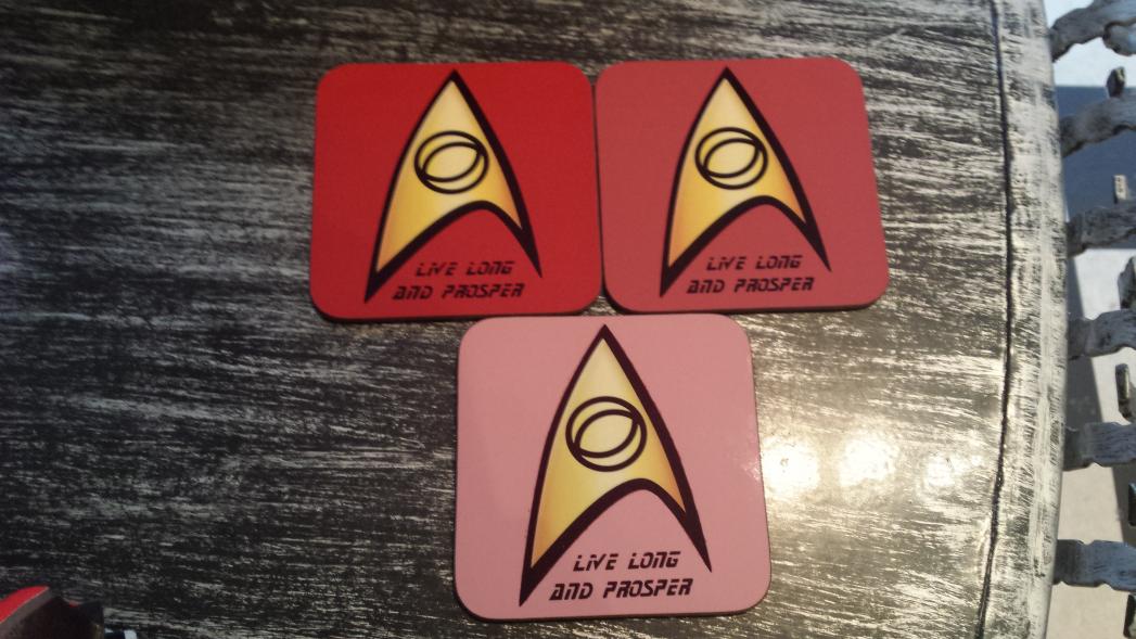

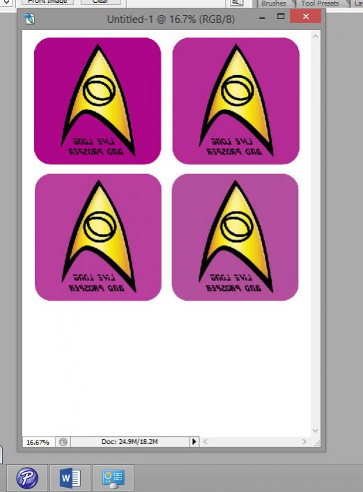

I am trying to print out purple and it is purple in Photoshop and when printed it comes out a red then when pressed an even deeper reddish colour
I have set up the printer in accordance with what our supplier suggested and through Sawgrass, but to no avail, majority of colours are fine, We have a few problems with green and blues too
I have attached some images in the hope that someone can tell me what I am doing wrong
Thank you
We are need of some help, this is driving me potty
Thank you

Re: RICOH 3310DN Desperate For Printing Help
blimey! consider yourself lucky
not many people can achieve so nice red with this printer
but seriously now... Do you use icc profile or powerDriver?
have you tried different settings for different blanks in PD?
Paul;97702 wrote:have you tried different settings for different blanks in PD?
yeah, i am going to reinstall and see if that works, we have a 3110 and a 7110 so will have to do it for both of them,
Thanks for your help
Are you using a RGB or CMYK colour model when generating your artwork
Hello AlanWe use RGBIt seems to be ok now, I have reinstalled on the 3110DN only and is printing fine, maybe it just needed an updateThanks for your reply
