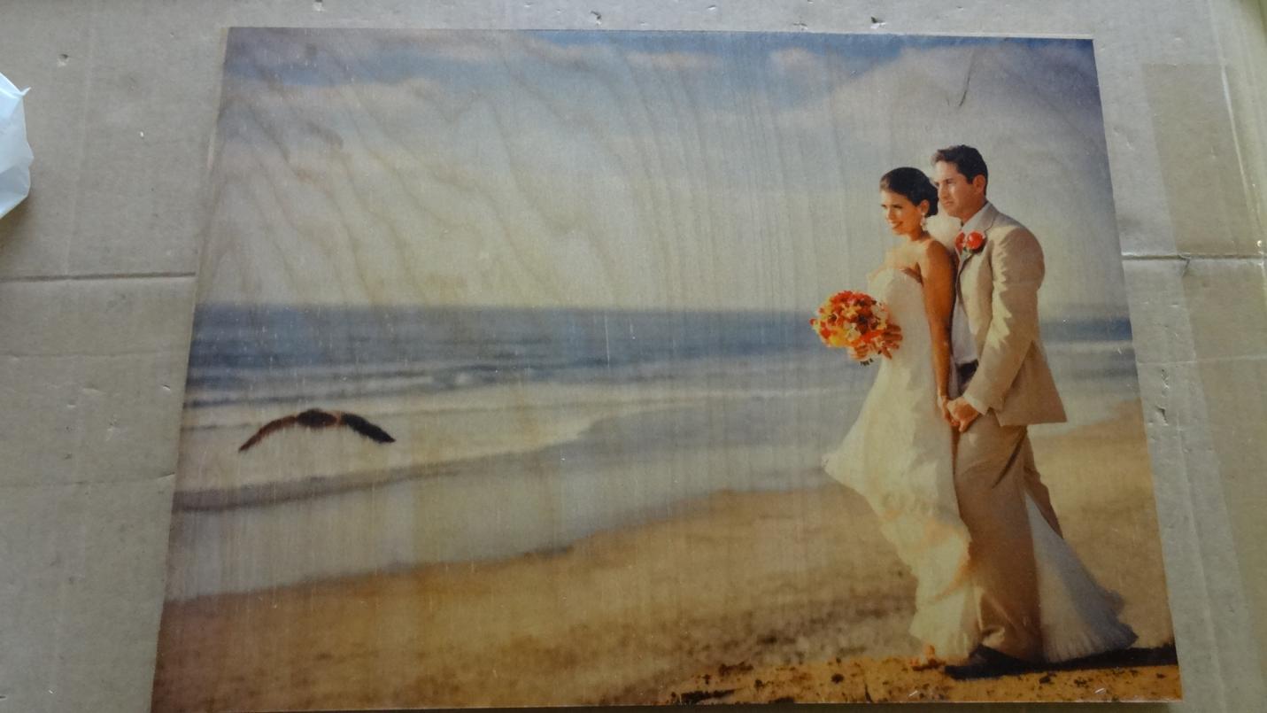

Thought I would experiment with some PU coatings from paint shop, first on ply, then mdf.

Can you give any details of what you used, spray or film, to do the coating with ?

Just found your earlier thread. Is this the ' Rasmart' you mentioned there ?

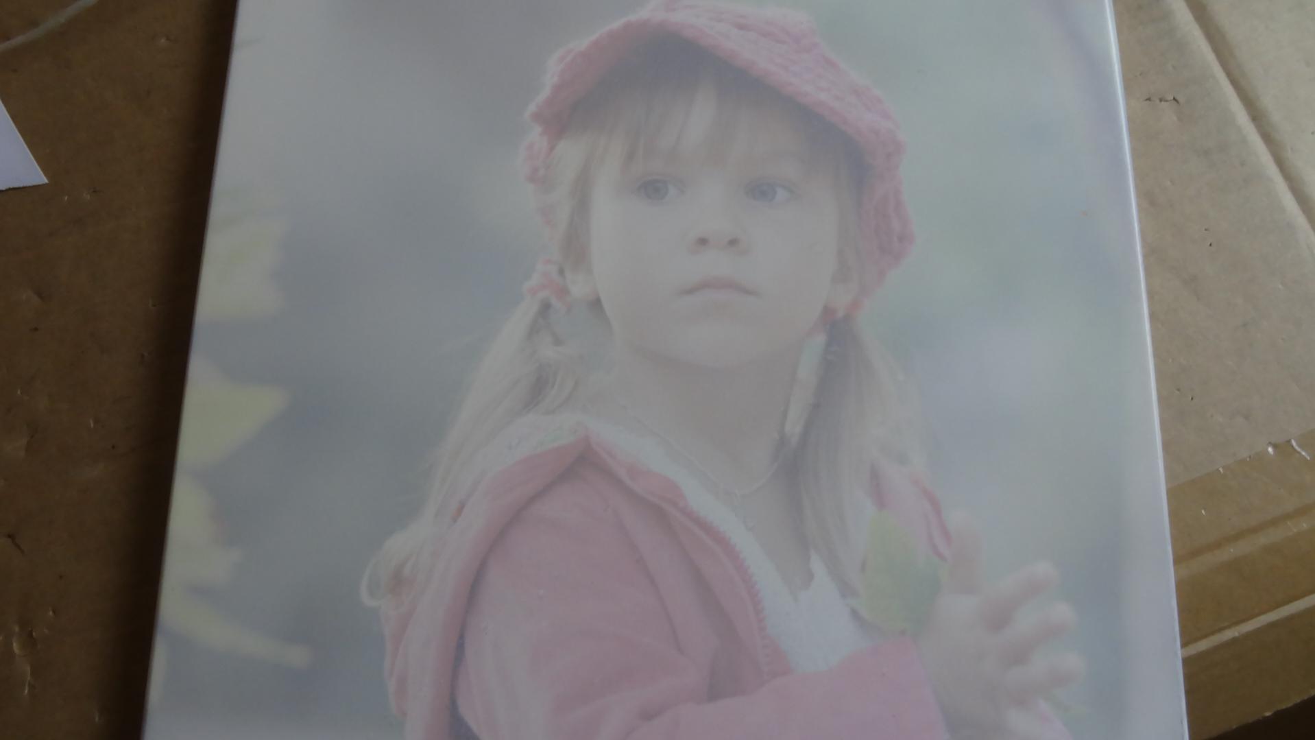

Hi, no the earlier thread was Rasmarts coatings, this is a specialised pu coating, the clear one works a treat, the white has a milky appearance which works with some prints but not others. I am working with a local chemist to try and find a way to sort it. My problem is I need a cost effective way to coat large (over 2 metre items). But Im getting there.

tracyreed;97643 wrote:............this is a specialised pu coating.......
I like the brilliance of the print. This is onto a pu coating on the ply ? I thought only polyester was possible, due to its chemical structure.
