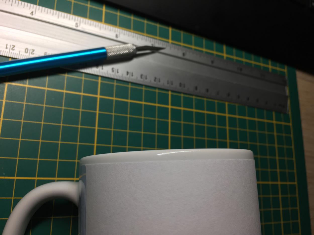

I am struggling badly with getting the image straight, i received my AAA Grade Duraglaze mugs today and because my mug press hasnt arrived yet from the UK i just cutted a 9cm x 22cm piece of paper and whatever i do the paper is always misaligned to the top and bottom. I can see that the gap to the top is larger at the front part of the mug compared to near the handle. It looks terrible. Is my printer not right? Maybe im doing something wrong. Now it looks like the height of the paper is higher near the handle compared to the front of the mug. I never thought that even such an easy task is hard to do. My printer cant be the problem because i am using A4 paper and cut it out myself with an exacto knife, it is very straight, that cant be the problem.

webtrekker;142004 wrote:All mugs taper towards the bottom to some degree. It's called the 'draft angle' and is needed to make sure the mugs release from the moulds. This causes the paper print to try and wrap itself conically, instead of cylindrically, around the mug. Make sure the mugs you order are as parallel as possible.
If you wanted to give yourself a lot of work you could design your wraps slightly curved to compensate for the taper (as in a latte mug, but nowhere near as severe) but I seriously doubt anyone would go to these lengths!
So if i choose a nearly top to bottom print this will be even more obvious i guess? When i look at printed mugs from others in youtube etc.. they all look pretty good aligned from the front to the back.

The paper on that mug doesn’t look straight to me anyway.
I have a black border around my prints 9.2cm x 22cm and print.
Then use a sliding cutter to cut just inside the border making sure not to leave any behind as this will leave a black line on the mug.
Not only does this ensure my prints are straight but my paper too.
