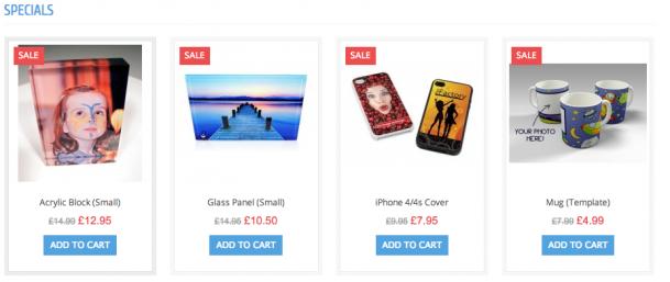

Could some kind member point me in the right direction please? On my home page, http://www.printshetland.com/ The text does not centre to the images for special/featured items. Just wondered if someone could tell me exactly where the line is that changes this save me searching?

Try the theme's stylesheet.css file.
Looks like it's set using padding attribute on ".box-product .name" and ".box-product .price". Set padding options to 0px and see if it fixes it..................

stylesheet.css
you have extra padding in
.box-product .name {
/* padding-left: 40px; */
/* padding-right: 5px; */
user chrome and inspect element to debug on the fly

Exactly as WePrintForYou says
Change padding-left to 0px, and padding-right to 0px.
Also, to centre the price, change
.box-product .price {padding-left:58px;}
to padding-left:0px;
Should end up with the below.
vB_ID:3174
vB_ID:3174
Screen Shot 2015-01-07 at 13.13.43.jpg (20.88 KiB) Viewed 852 times

Said if before, you guys are the best! Just what I needed, straight to the right section, changed, job done. Save me a fair bit of time, many thanks! :-)
