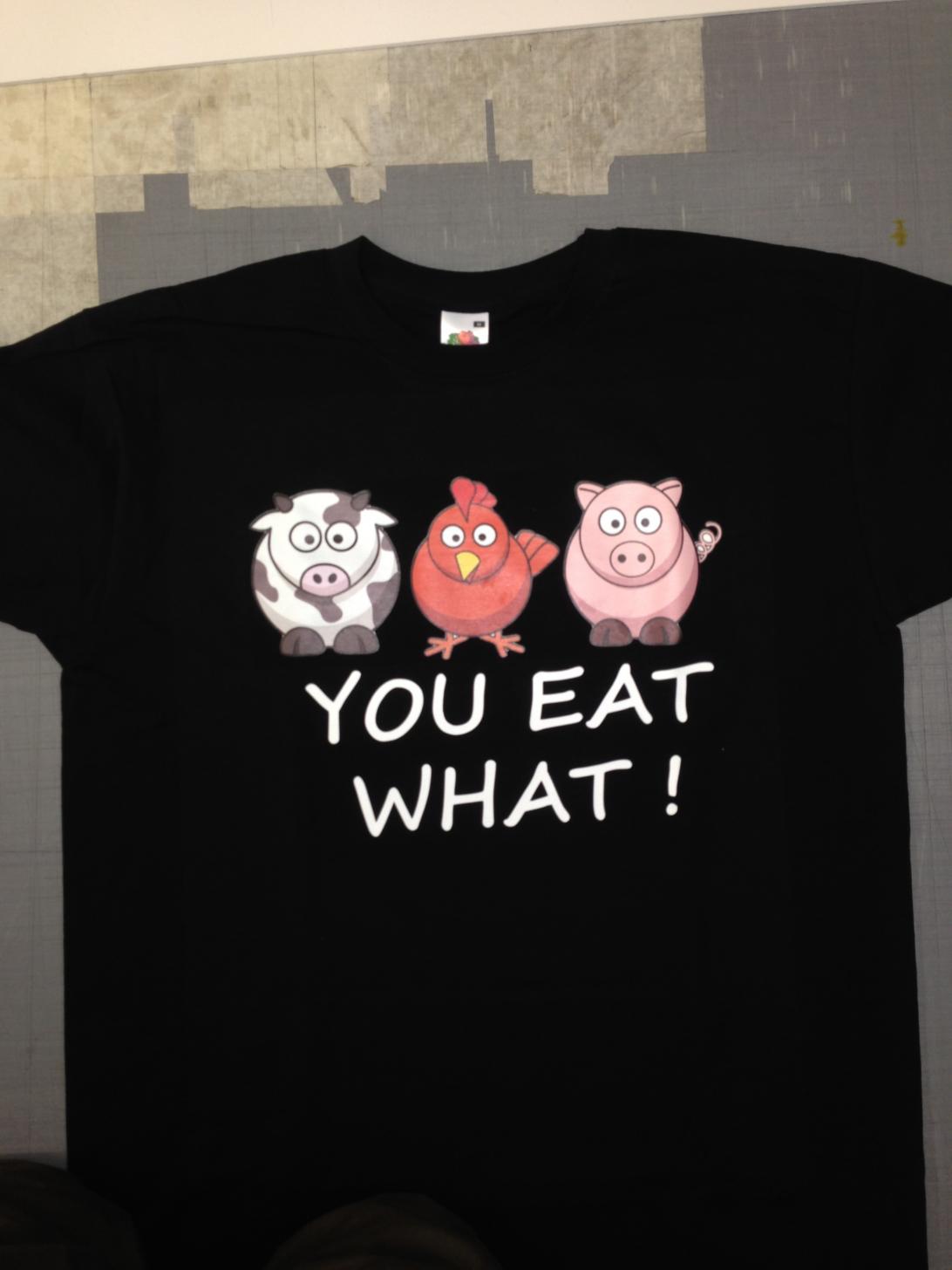

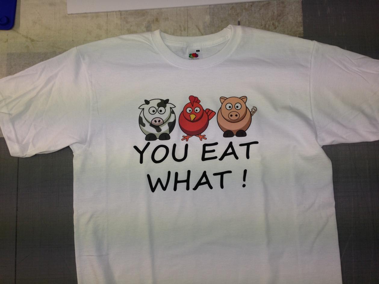

Hello Windy
Ive been using the MDP Hot Flex and have to say its been pretty good, cant really compare it to anything as this is my first attempt at garment printing.
Using that and DigiFlex, the printable vinyl from MDP and that to has been good.
I also had a go with Jet Pro Soft Stretch and was pleasantly surprised, it was a pain to get the pressure right to contour cut the image on the Mimaki CG130, but managed to get it.
I'll try to post the pics of the first couple of t shirts I done, the white one is the jetpro ss with vinyl letters and the black one is digiflex with vinyl letters.
Cheers
Bob
