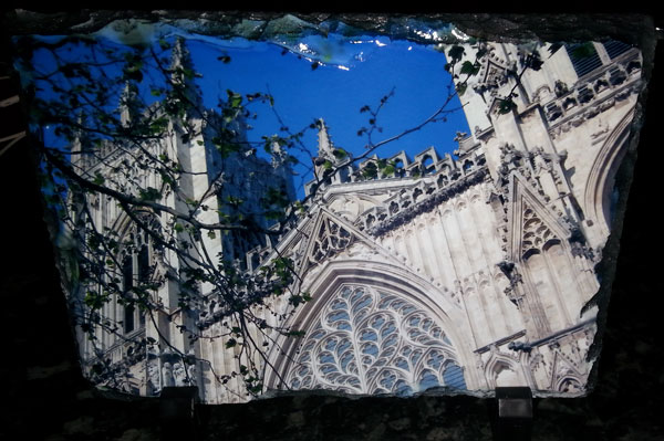

hi all i have read throw this many times and decided to get some slates,
now i like making everything in an oven unless it needs to be done quicker, then i will move to heat presses..
i done a photo slate in the halogen oven
temp 200, time 8 mins, i have attached a image to show the finsihed result.
[ATTACH=CONFIG]2086[/ATTACH]
This was an order i think it looks fine my first 2 went yellow so this is much much better considering
- vB_ID:2086
- photo.jpg (102.07 KiB) Viewed 417 times
Dave271069
- Posts: 1134
- Joined: 26 Apr 2012, 22:44
Re: sublimation slates
How did you apply pressure from the paper to the slate in the oven or did you not use anything?
Designandgift
- Posts: 128
- Joined: 24 Oct 2013, 15:49
i wrapped the image like you guys said, then i put the slate, image face down on to the metal rack inside the oven, so i basically used the slate as its own weight. i did . i got no streaks or blow outs from any slate i done today, but some was yellow in colour from over baking id imagine... im really impressed with the outcome and only thought of the oven when my heat press was playing up so i thought i would shareDave271069;78743 wrote:How did you apply pressure from the paper to the slate in the oven or did you not use anything?

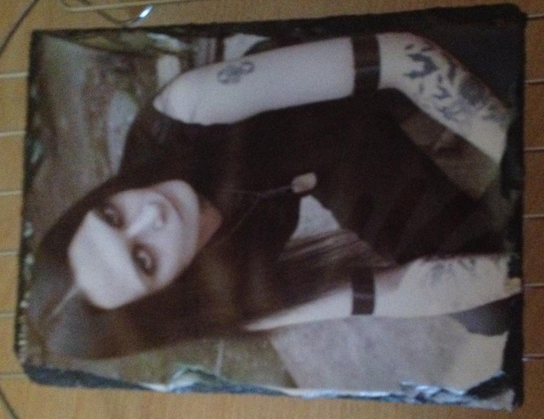

well I printed my first slate yesterday, and really happy with how it turned out! followed pauls video, and worked a charm. turned out a silicon mug wrap I had purchased before was just about the right size for the slate, so didn't have to buy any more!
