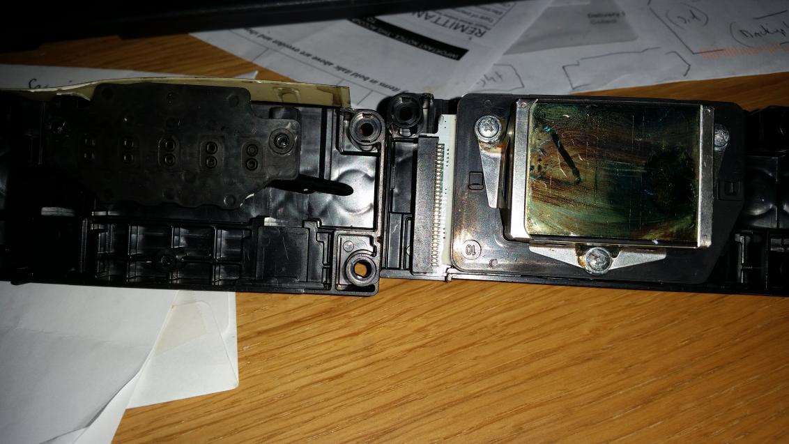

You can temove this from underneath its called the manifold .
See pucs
[ATTACH=CONFIG]3869[/ATTACH]
