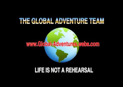

I am about to do my very first press, as you can see from my image I need to work out a way of making sure the elements line up properly as they are not connected. ALSO this film does not have a sticky backing so this should be fun.
Oh, and my XP-205 is doing it's usual (Ink and Paper Jam) light routine after only a few jobs - this really does annoy me.
[ATTACH=CONFIG]2003[/ATTACH]
I have got rid of all the black and just done a Black stroke over the top of everything, made my sutter contour cut .1mm into this stroke so I dont have to print that black (I cant upload my .Tiff file of this).

you can try application tape to transfer all elements to the shirt.
Re: FlexiSign 10 Black Lines over everything.
Agree with that, especially the way you are trying to do it. IMHO Siser application tape sold by Grafityp is the best around.you can try application tape to transfer all elements to the shirt.
I have a couple of types of Application tape here but I dont see how that could work as this Yolo paper does not have a sticky backing - it's smooth plastic type material ! I can just push it about the garment !
