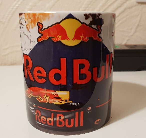

I went and bought one of these too and bought the Cityinkexpress paper to go with my CIE inks. WOW!!!!!!webtrekker;128436 wrote:I thought I'd try a halogen mug oven to see if there were any advantages/disadvantages over a mug press or a conventional electric/gas cooker.
Well, I only received it yesterday, but so far the results are excellent!
This is the oven ...
You may notice that I have an oven thermometer in there too. This is because you can't trust the temperature dial to give you the exact temperature you need for sublimation. With the dial set at 180 deg C it was only measuring 160 deg C on the thermometer, so I fiddled around and now have it 'cooking' at 180 deg C. The thermometer was £3.99 from Amazon.
I've now got it down to 10 mins to print a single mug, using the cheap (less than a fiver) silicone mug wraps from ebay. I haven't had time to try 4 mugs yet but I'll get around to it soon.
The prints blew me away! MUCH sharper than any I've produced with my mug presses, particulary small text. Colours were great and uniform, and black was very black, not brown. Inks and paper are the same I've always used, from City Ink Express. Mugs are 10oz Listawood Duraglaze Durham AAA.
These ovens only take a few minutes to reach temperature, which is good. The very bright light of the halogen bulb switching on and off is a bit annoying when I'm working on the computer at the same time, but bearable. You can hear the blower but it's nothing excessive and the only other sound is the timer ticking.
All in all, it looks like I'm going to be doing most, if not all of my mugs in the oven from now on.
I am mightily impressed. Full wrap on two mugs and both perfect. A fraction of the cost of the Galaxy Pro mug press. I too bought a cheapo thermometer from Amazon and have the oven dialled in at 180c.
Oven at 180c for 15 minutes for two mugs.
Blown away to be honest. This is my new method now going forward. Mug for personal consumption BTW and not resale

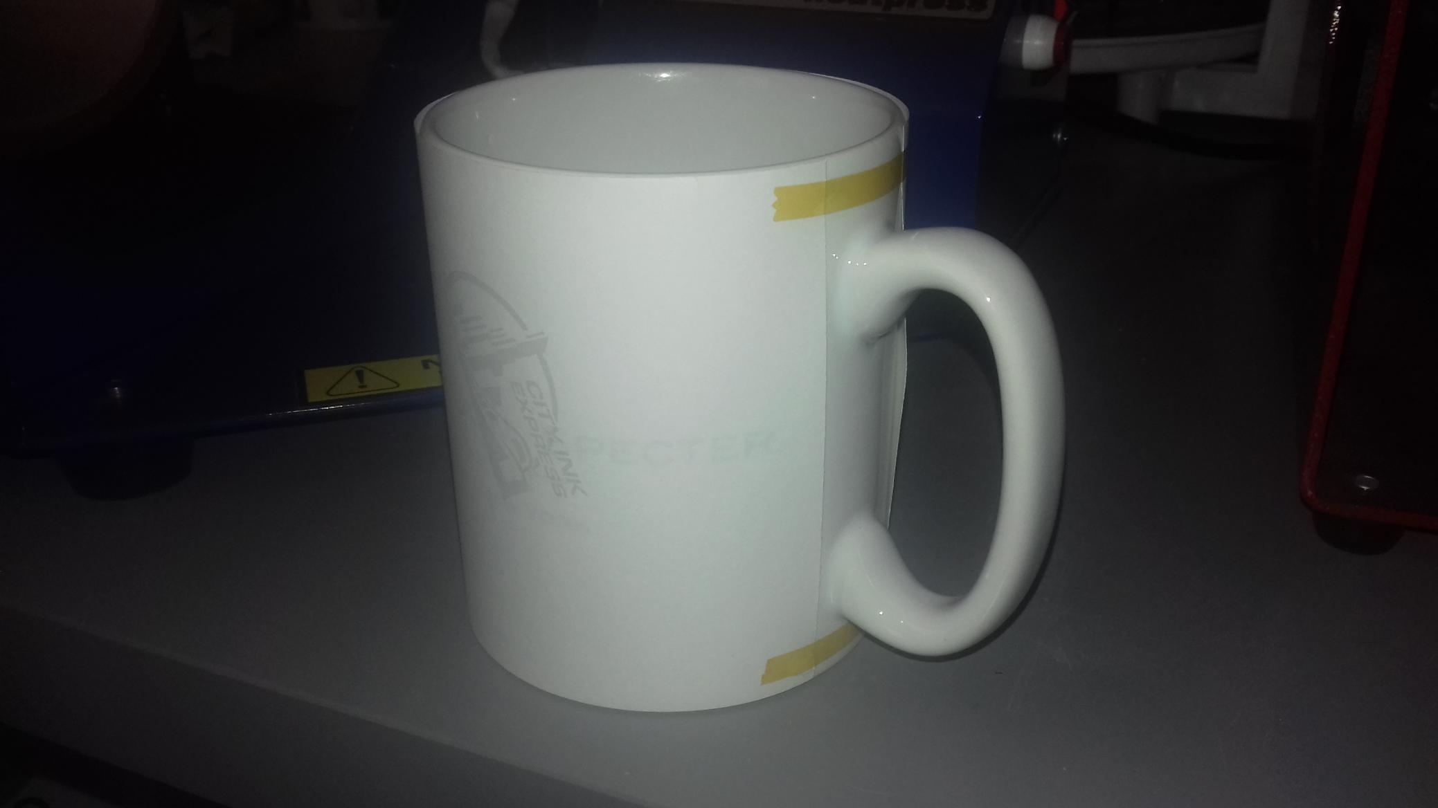

well there are some older threads about the heat tape marking so it's not just me and the reason it doesn't do it in the heat press is ecause it is not getting heated near the handle in th epress the way it is in the oven. I've took the tempas low as I can go without it effecting the inks and I still get the yellow marks, its the xpress mugs I'm using and I'm down to 170C. anyway i'm getting round it by using paper to bridge the gap under the handles but I just wanted to warn others.webtrekker;135169 wrote:That's the top tip. Waiting until everything warms up to 180 starts everything off on a level playing field.
@smiley_mug Regarding heat tape, I've never experienced yellow marks from the tape. As this doesn't seem to happen in your mug press I'd say that your oven temperature is maybe higher than what you think.

- 20180910_132107.jpg (83.27 KiB) Viewed 391 times
smiley_mug
- Posts: 71
- Joined: 20 Jun 2016, 12:42
Re: Halogen mug oven ... first impressions ...
The heat tape staining must be a problem specific to my mug type. Your comment prompted me to check the first mugs I did, i used some cheap ebay mugs that aren't dishwasher safe for experimenting to get my temps/times about right and they don't have the marks even though the temp was a lot higher on my early trials. Must be to do with the coating.
