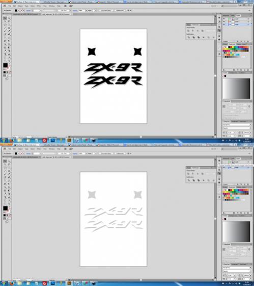

ok, spent the day on this and a few other related tasks.
I have managed to separate the colours onto different layers in AI - I followed this: Ear. I had no luck with any kind of Tracing.

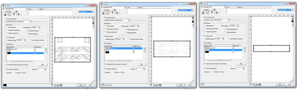

The only problem I am having now is getting my registration 'Stars' (in this case although I will settle on more of an appropriate registration shape in time) to save with the other layers - all in the same place.. I am saving the file as .eps and opening it in Flexi and even though the colours are clearly separated (as I wanted) the 'Stars' are being placed elsewhere on the preview in Flexi which means they are considered separate even though I have grey ones on the grey later and black ones on the black layer :(
[ATTACH=CONFIG]1993[/ATTACH]
Nightmare, but I am getting there :)
[ATTACH=CONFIG]1994[/ATTACH]
.. I do understand that it is Flexi's production Manager just trying to save me vinyl but as the stars are the same colours, and on the same layer surely I should be able to send complete layers to Flexi ?
Break Through - I see 'Automatic Registration Lines' (In Production Manager).. And they cut :) I knew there was a light at the end of the Tunnel - but I would still like to know why it's difficult doing it the way I outlined above :(

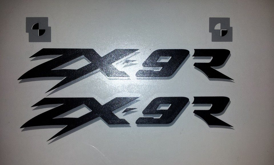

Success - I worked it out.
[ATTACH=CONFIG]1998[/ATTACH]
I know its not perfect - I tried to do three at a time.
Now to figure out how to do 4 Part Rim Stripes.
