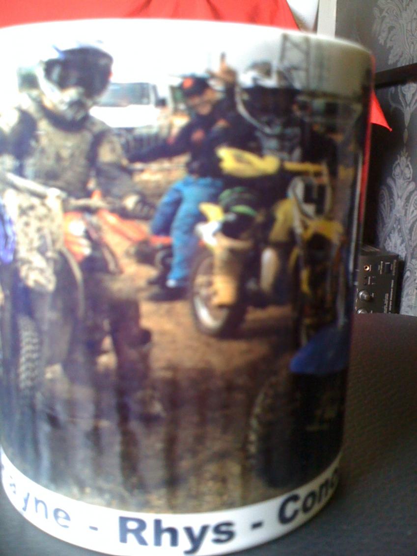

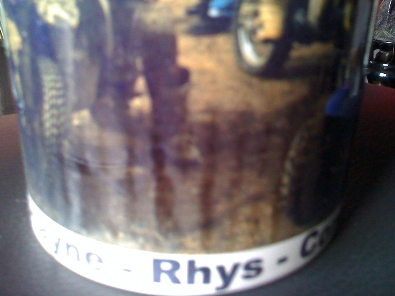

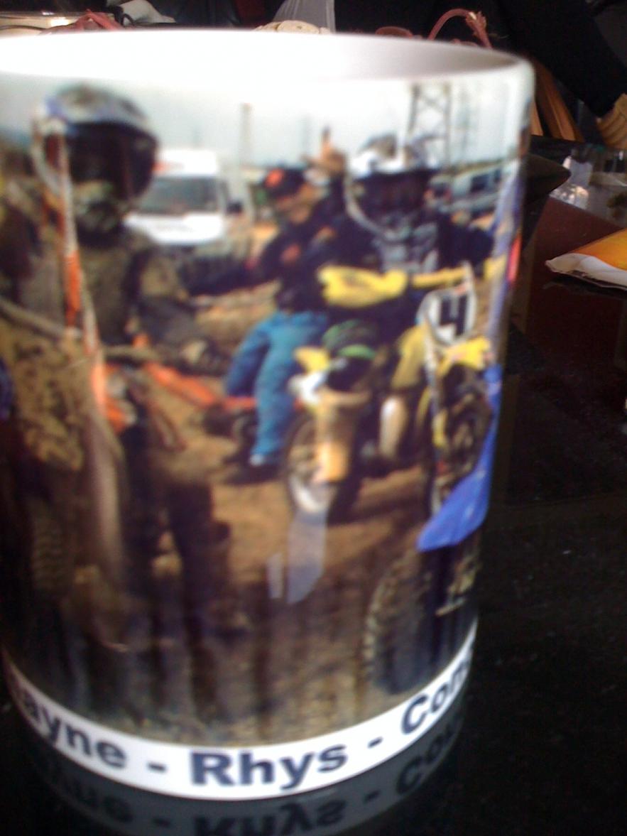

Got a quick question for you on pressing the mug. When i pressed the mug towards the bottom i was getting like darker lines in the middle of the cup towards bottom. I am thinking that i am not applying enough pressure.
I use a coral4 mug press and use coral 10oz mugs.

180 degrees C and 180 seconds. top half of mug is perfect its just towards bottom in the centre of the mug. I looked at my other test mugs just now that went terrible wrong to see if they had the same lines when i had the pressure set to more.
For some strange reason i decided to back off the pressure. I have adjusted pressure back up so will print another tomorrow morning and see if that cures it.

Here are the pics of the mug. As you can see at the bottom there are dark lines going down and in between the lines it looks faded.
I am preheating the mug press with a blank mug in and then switching mugs once preheated and doing them at 180 C / 180 seconds.

Post by WorthDoingRight »
Well those white lines are where the sublimation ink did not transfer properly. Do you have a flatbed press? If so try drying your paper by pressing it for a few seconds with heat before printing. If you do not then leave your paper to dry after printing before transferring to your mug press. Also make sure that your press is tight enough to uniformly clamp the mug and if that doesnt help them consider increasing your temperature by 5 or 10 degrees and your time also. It might also be worth trying a different type of higher release paper. On my high release paper there is barely any image left on the paper after pressing on the mug.
