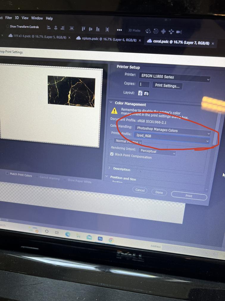

Show me where you are applying your profile?

Post by caca »
here i choose ICC profile

Re: Epson l1800 printing on sublimation film problem
So the profile given to you is called iPad_RGB?
Post by caca »
Yes, correct
Uhm, strange name for a profile, this was from Ink Experts? I'm going to send you a profile to compare.
Post by caca »
No i got it from my sublimation film and other items supplier who told me to use this icc for epson l1800 and sublinova inks and film. Please send me other profile for epson l1800 to do sublimation with sublinova inks on sublimation film. What paper type i need to choose in the settings?
OK, have you spoken to them about the profile? I've sent you a different one, let me know how that compares.
Post by caca »
Yes, they also just sent me other icc profile so i will try to use it also. What paper type i need to choose in the settings with your icc?
Epson Matte
