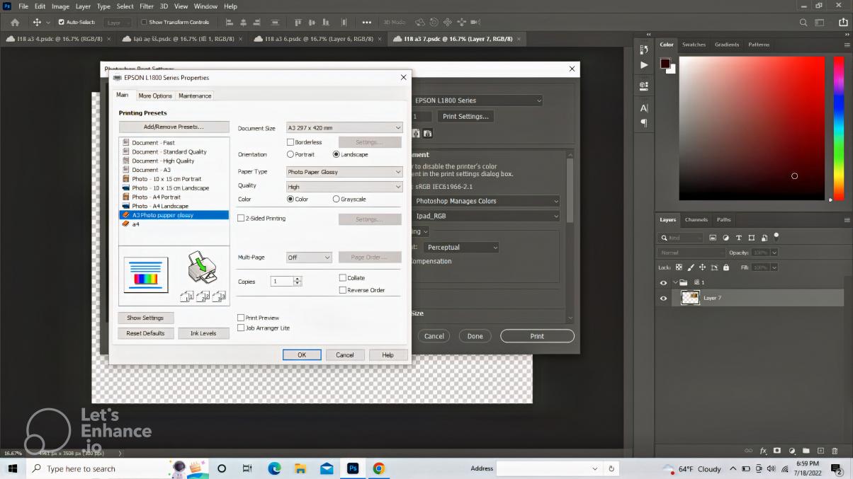

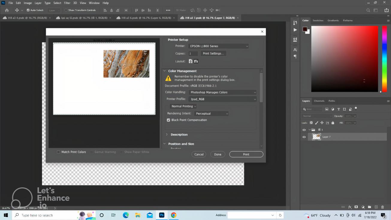

Re: Epson l1800 printing on sublimation film problem
I can't clearly see your attachments as the images are too small. I can read Epson Glossy which for a start is wrong. Please upload clearer images and I will compare for you.
I attach photo. One printer settings with my supplier sent icc profile which colors after sublimation are not good. And other i just choose epson l1800 glossy.
Usually when it printed the colors looks good, but after sublimation on the case these colors is not good.
Sorry, now tou should see, thank you.
Have you turned off colour management in the print dialogue? Click the 'more options' tab and send us a screen shot.
There should be a 'colour management' option. Click 'ICM' and then click 'off'. This will stop the printer having any control over the colours printed and leave full control to Photoshop. If you leave ICM 'on' then the printer will counteract the profiled colours from Photoshop and you won't get a true profiled image.
Hello, yes colour management is turned off all the time. I always turn it off before printing.
