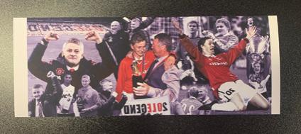

The printed image should resemble something similar to the image posted. I am aware that this one is slightly out, it is the only print I had that did not have any confidentiality clause or strict copyright restrictions that I did not want copied
This image will wrap around the entire mug and print edge to edge top and bottom. There is no excess paper and, more importantly for oven users, no excess ink
