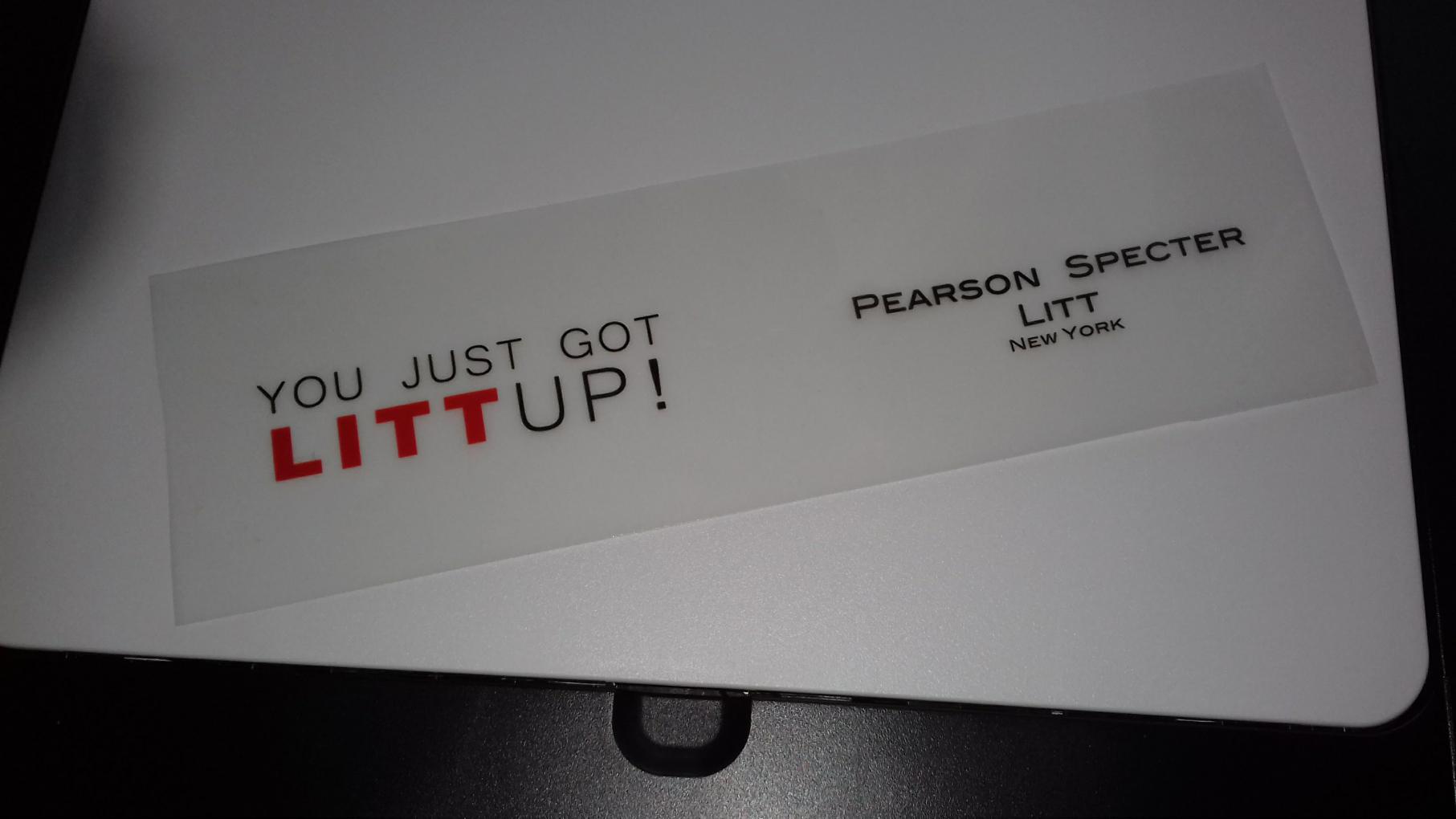

Slight change of tack while I await further samples of acrylic to arrive.
I have some Mylar stencil material (transparent and cloudy) which I use for cutting stencils with my contour cutter, so I thought I'd give it a go as Mylar is, essentially, polyethylene and should print ok.
Well, it worked! Pressed at 190 °C for 60 secs. I may be able to reduce these times and temps.

Looks good
As you say, Mylar is Dupont's trade name for a modified PET, the PE bit being Polyethylene
Have you got any PET to try?
Re: FRP sheets...
190 seems high, should be able to back it down to 180 (we go as low as 160 for some fabrics.)
You may be able to get the times down to 30-45srcs too
Re: FRP sheets...
[MENTION=5206]knightweb[/MENTION] - unfortunately I haven't any PET lying around but may get hold of some to try out now seeing as the Mylar was successful.
[MENTION=1209]pisquee[/MENTION] - Yes, I need to fiddle around with times and temps as I suspect my first attempt was a bit overcooked.

webtrekker;137563 wrote:Slight change of tack while I await further samples of acrylic to arrive.
Looks neat, what ink and paper did you use?
I did not know about Mylar and was wondering if my Graphtec plotter would cut stencils, or do you have a dedicated cutter.
You guy's have got my head working over-time when I should be on a deserted beach with two fishing rods:biggrin:
LB
Re: FRP sheets...
[MENTION=9387]Leadbelly[/MENTION] - I use 125 micron stencil sheets. It can be easily cut, even with just a Cameo, as long as your cutter can use a cutting mat. One idea that I'm currently considering is making printed sleeves to slide over crush-proof mug boxes to make them more attractive to the customer.
The inks I use are the ones I use for all my sublimation work - from CIE, using their paper and ICC profile in my Ricoh SG3110DN printers. I get a much denser, more durable print than I got using transparency film in my Canon inkjet.
Mylar is tough and hard to wrinkle, yet cuts easily and can be creased. It's less than £1 for a 450mm x 600mm sheet (so less than 25p a sheet when cut to A4 size) and you could possibly do better than that by ordering in larger sizes or bigger quantities.
As for stencils, the Mylar is food-safe so can be used by cake decorators as well as the more basic uses on walls etc.
