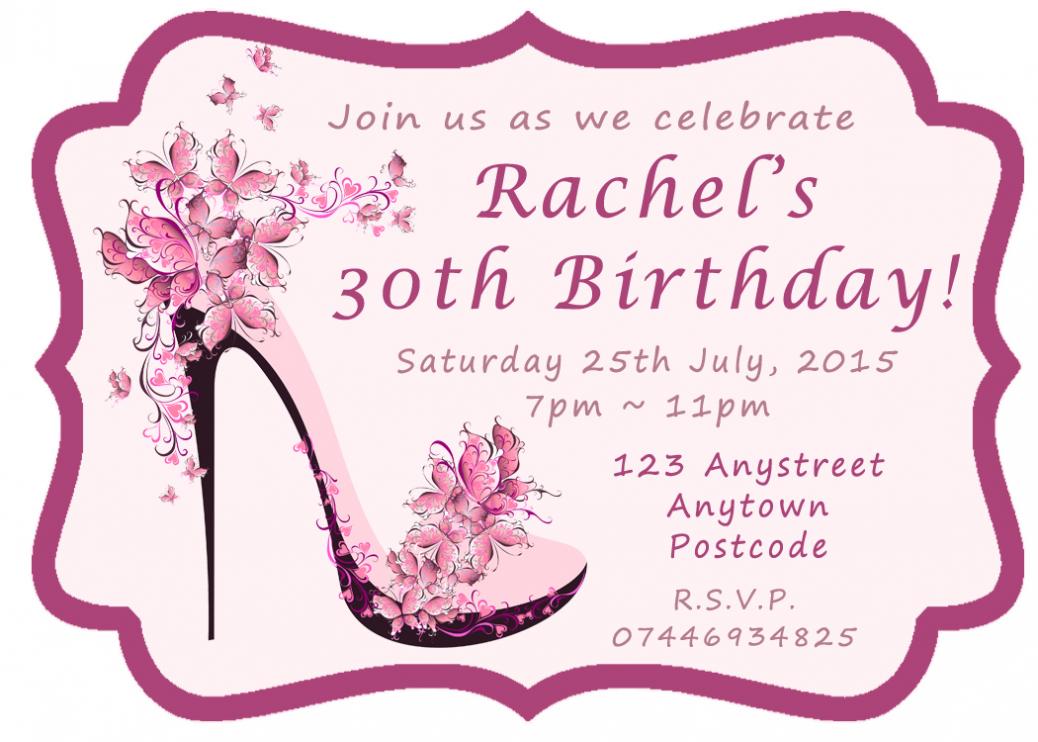

I cut printable magnetic sheets on a weekly basis for magnetic party invitations that the organiser can send out to guests and they stick them on their fridge or microwave as reminders of the forthcoming event. I've cut thousands of these. Admittedly, my Silhouette Cameo struggled with them, but my Silver Bullet cutter slides through them like Fred Astaire on baby oil!
Obviously, if you're sticking magnetic sheet to the reverse of an aluminium shape then you don't need to have printable sheets, just ordinary black stuff off the roll will do.
Here's the type of invititation I used to contour cut, 9 (credit card sized) to a 50p A4 sheet -
vB_ID:5257
vB_ID:5257

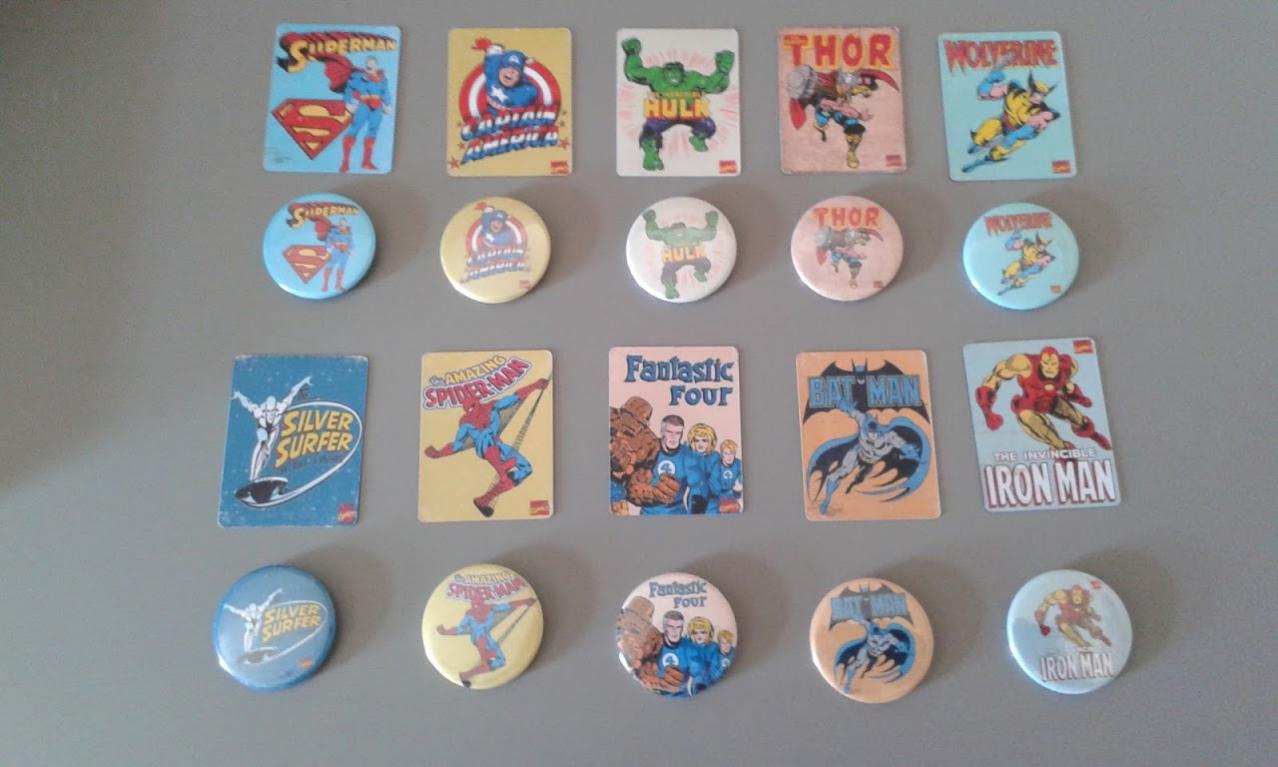

And a Retro Superhero badge and fridge magnet set I made for my nephew -
vB_ID:5257
vB_ID:5257
vB_ID:5256
vB_ID:5256
