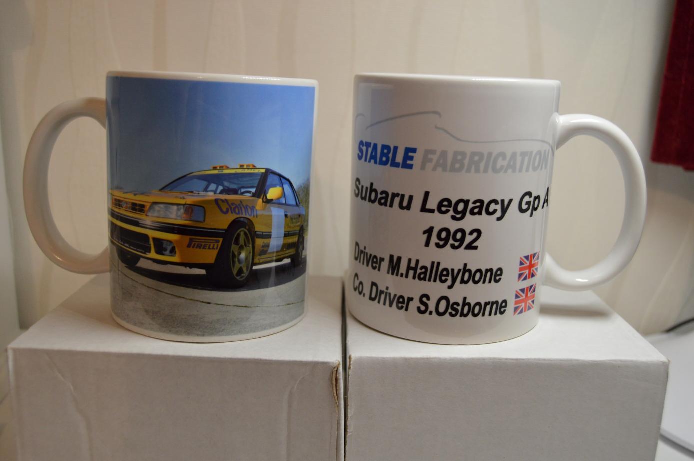

Thanks Webtrekker did 2 @ 200 deg. for 12 mins. not 100% perfect but not far off, good enough for freebies at work.

Well this is the result, as I say not perfect.
Re: Halogen mug oven ... first impressions ...
Look good to me! You can't be that far off.

Done a number of mugs in the halogen 2 at a time 200 deg. for 12 mins. and coming out fine.
I now have 6 more to do so want to try 3 at a time what do you clever people think I should time it at was thinking 15mins.

The bleeding is just over printing. If thin text bled, I would reduce the time by 10 seconds whatever in a normal heat press and whip the transfer off immediately.
If you've got 15 minutes to play with, perhaps reduce time by 2-3 mins? I'm just trying to think if these ovens are a good way to scale up and improve speed?
