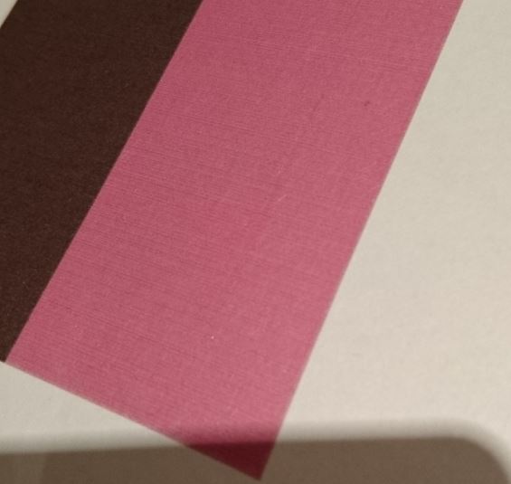

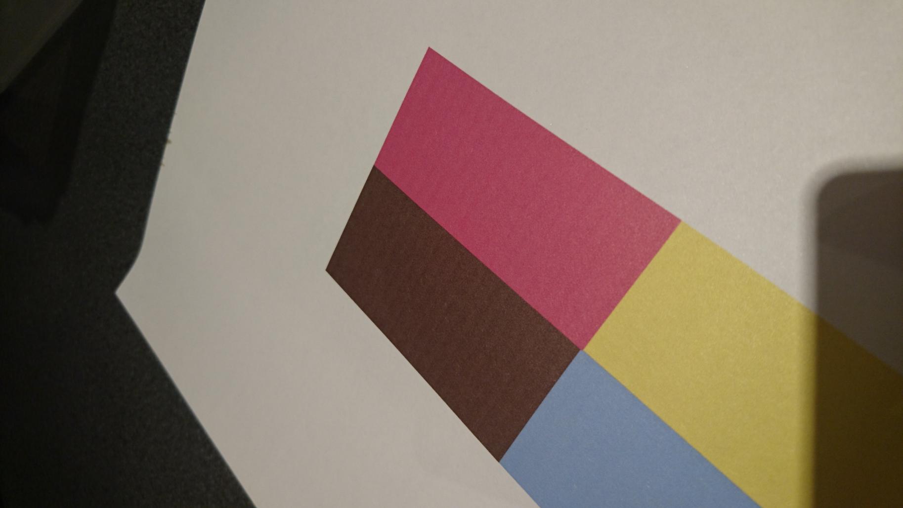

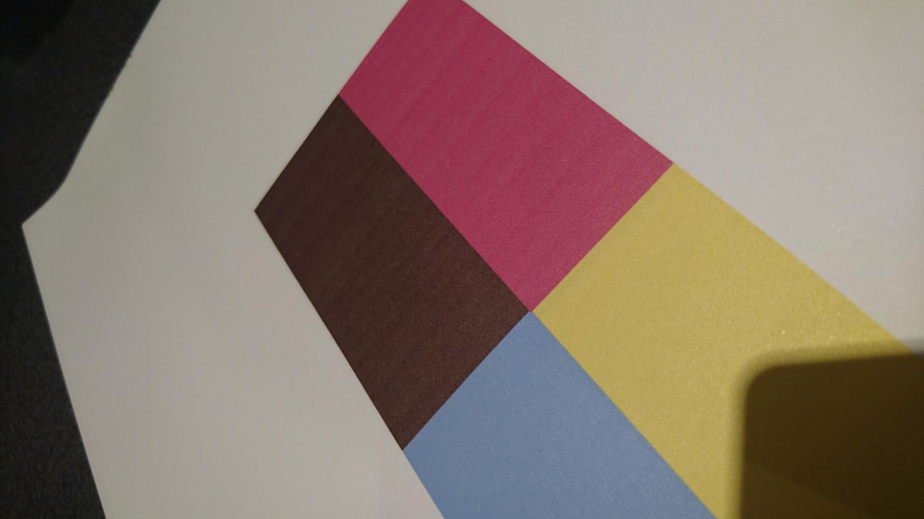

Ok so Adobe PS CC produced the same magenta white banding, so no good.
HOWEVER!!!!
CoralDraw 8 produced perfect magenta with CIE, xpres and TruPix paper WITH their corresponding ICC profile. I have attached one photoshop print and one corel draw print, both using 100% magenta.
So Photoshop CS6 is definitely the problem, not the printer, now I just need to figure out how to fix it!
Stay tuned.
HOWEVER!!!!
Stay tuned.

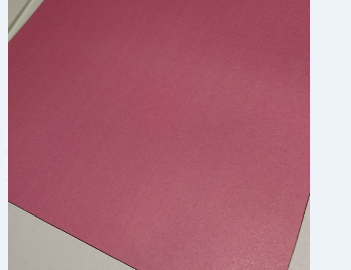

Re: Ricoh SG3110DN white lines problem
So I took a punt and got an Epson wf7110 with ciss.
As expected, this did not fix the issue, horizontal banding in magenta and black. I now have a very large and expensive paperweight if anyone wants it?
I've also done a complete teardown and reassembly of my ricoh print head, will get a new thread up in case anyone else wants to do a manual clean of their sg3110
[ATTACH=CONFIG]4528[/ATTACH]
[ATTACH=CONFIG]4529[/ATTACH]
