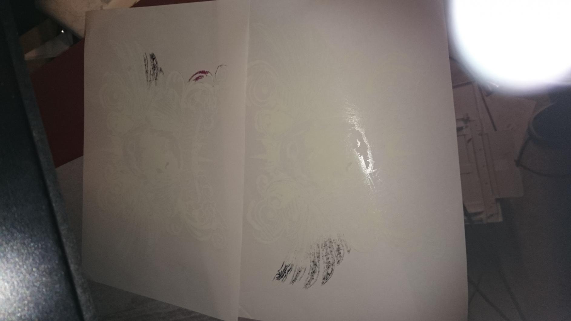

Looks like insufficient or uneven pressure and a bit too cold. If the pressure is OK then are you keeping finger grease off of the papers ?
I presume you are using OKI original toner and not low cost refills.

no greasy fingers, the proper inks that come with the oki printers from the transfer press as part of sunangel system, pressure is the main thing im thinking, i am using 130c and 40 seconds which should be ample so thinking the pressure is the problem.

so I have a better press now but having more issues papers are peeling well but when peeling backing paper from the shirt some of the paper is staying behind on the image part of the shirt as though a layer of the paper is torn off when peeling don't know if pressure is too heavy or too light when I had it higher the image was getting peeled off completely onto the adhesive sheet...
