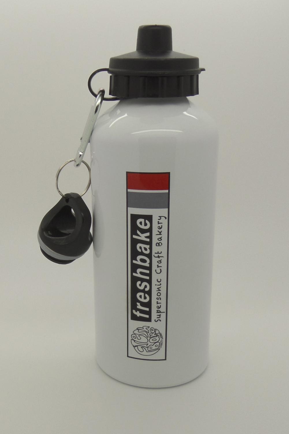

[ATTACH=CONFIG]2871[/ATTACH]
215c for 105 secs - design on both sides.
