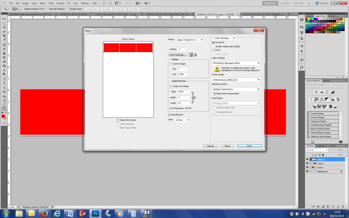

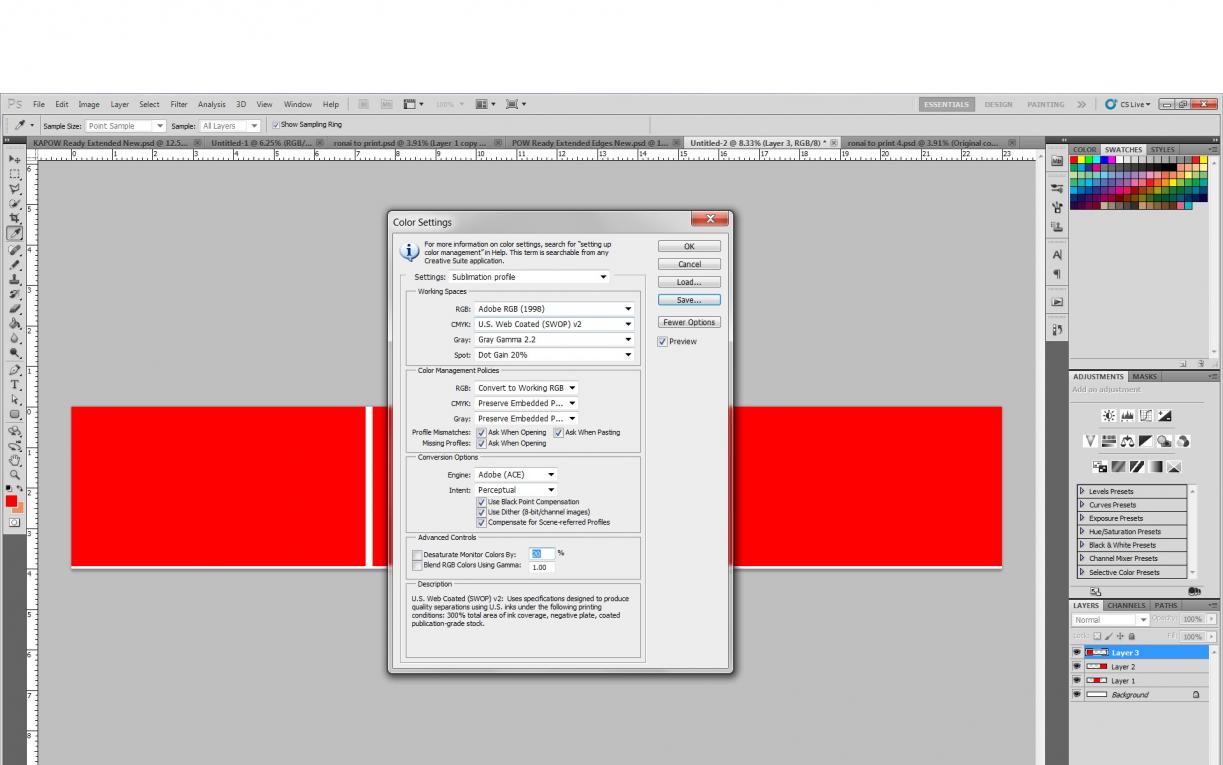

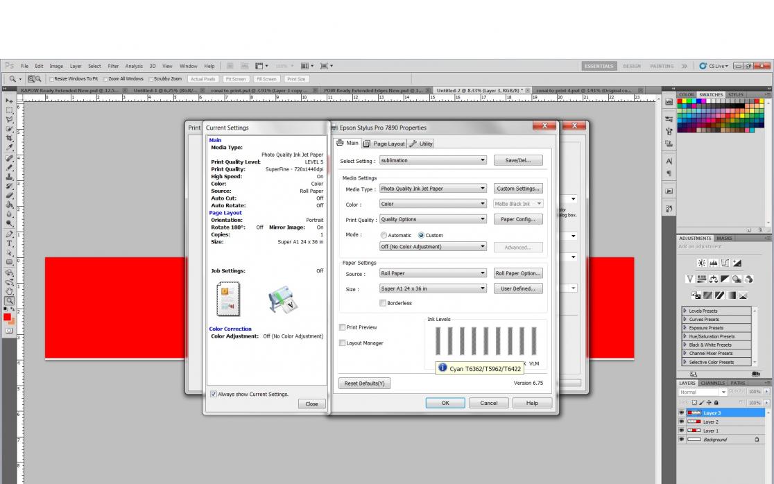

Attached are 3 images of my settings. Am I doing something wrong?[ATTACH=CONFIG]2496[/ATTACH][ATTACH=CONFIG]2497[/ATTACH][ATTACH=CONFIG]2498[/ATTACH]

Which graphics program/ version did you use to print?
Photomouse
Posts: 77
Joined: 14 Oct 2013, 14:16
Re: Red looks orange on faux suede
Post by Photomouse »
I use Photoshop CS5 to edit and print.

When you were printing out the profile charts did you use Photoshop?
I had the same problem, newer versions of Photoshop only have a choice of Printer manages colour or Photoshop manages colour which adds its own profile..even when you set No colour adjustment.
You need to use the Adobe Colour Print Adjustment tool to print the ICC charts.

I did use that tool as Paul sent it with the instructions
When you did the test chart printing, were the printer quality/media settings the same as in your 2nd picture?
Photomouse
Posts: 77
Yes. The media type is what I was told to use for trupix paper.
