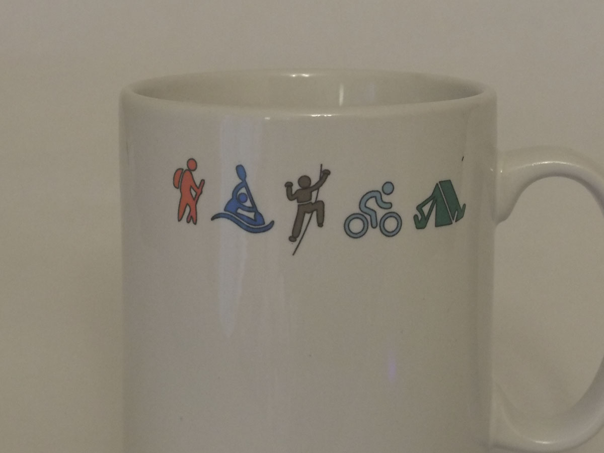

170 degrees 80 sec - very clear print [ATTACH=CONFIG]2427[/ATTACH], at 100 sec started to blur, at 120sec blurred. At 50 sec still ok and first time that didn't scorch the paper

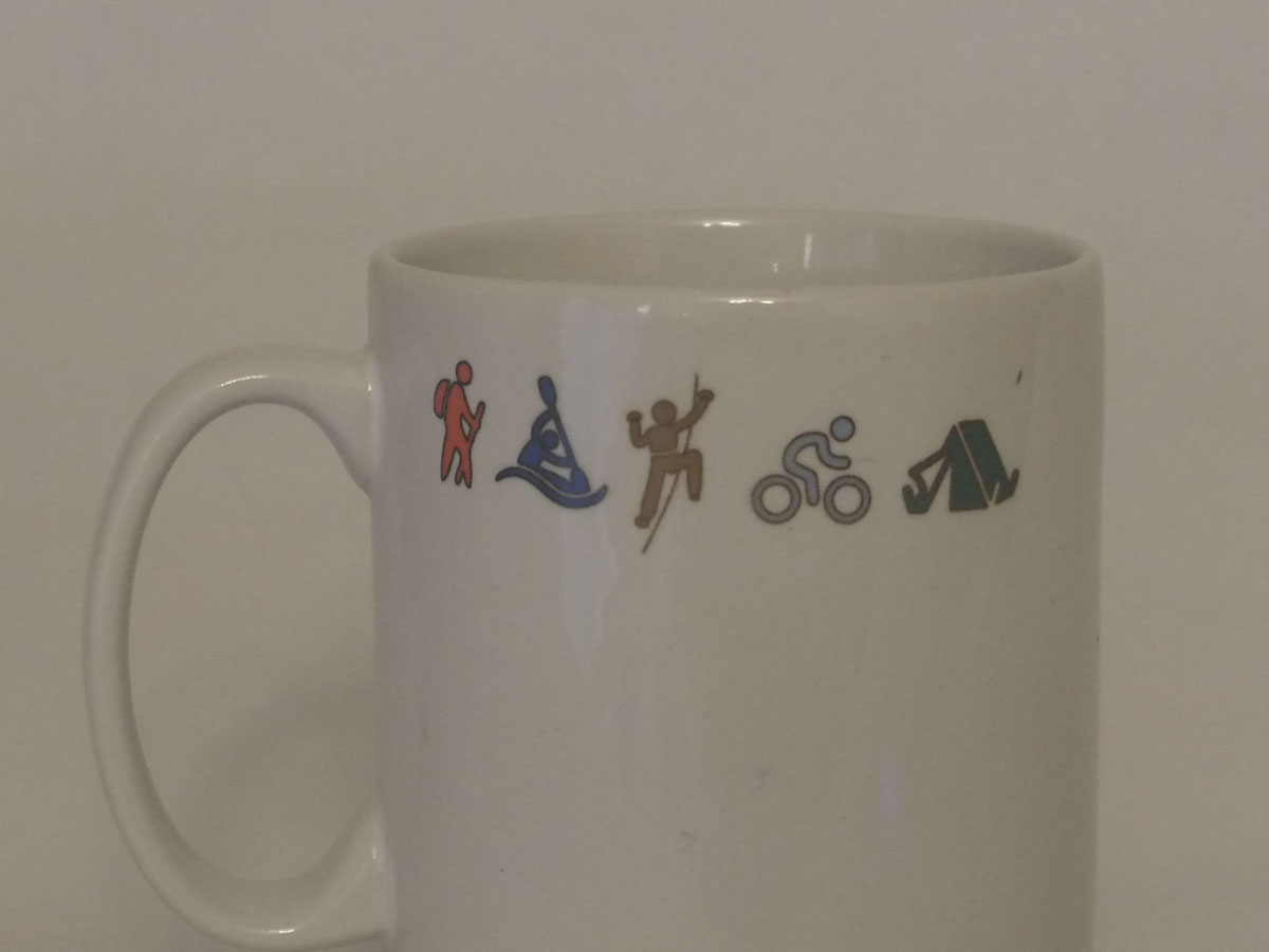

155 degrees 80 sec . [ATTACH=CONFIG]2423[/ATTACH] Can't see any noticeable difference from the above. (very similar result at 150 degrees 60 sec)

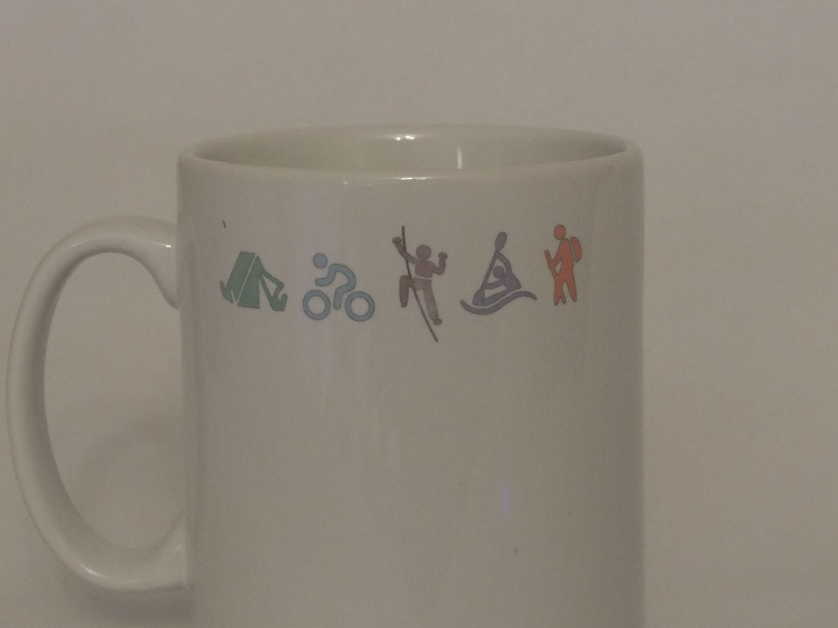

went mad and tried 190 degrees 60 sec. [ATTACH=CONFIG]2428[/ATTACH] too hot - blacks very definitely brown, but the rest of the colours seem the same

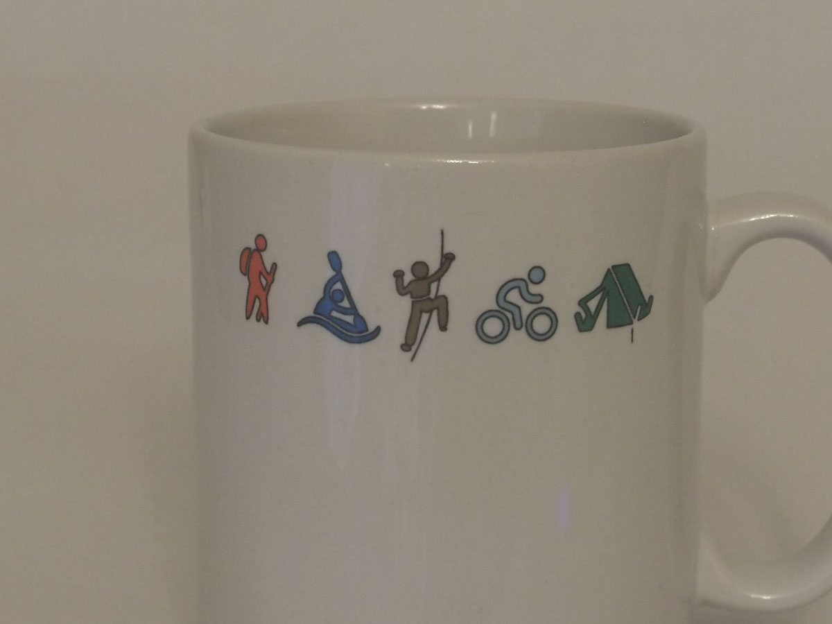

Tried the other end of the scale - 140 degrees 60 sec. [ATTACH=CONFIG]2426[/ATTACH] Surprised that it printed at all as I thought the ink didn't sublimate at this temp

- vB_ID:2428
- 190d 60s.jpg (86.77 KiB) Viewed 76 times
- vB_ID:2427
- 170d 80s.jpg (88.63 KiB) Viewed 76 times
- vB_ID:2426
- 140d 60s.jpg (85.61 KiB) Viewed 76 times
- vB_ID:2423
- 155d 80s.jpg (87.6 KiB) Viewed 76 times
