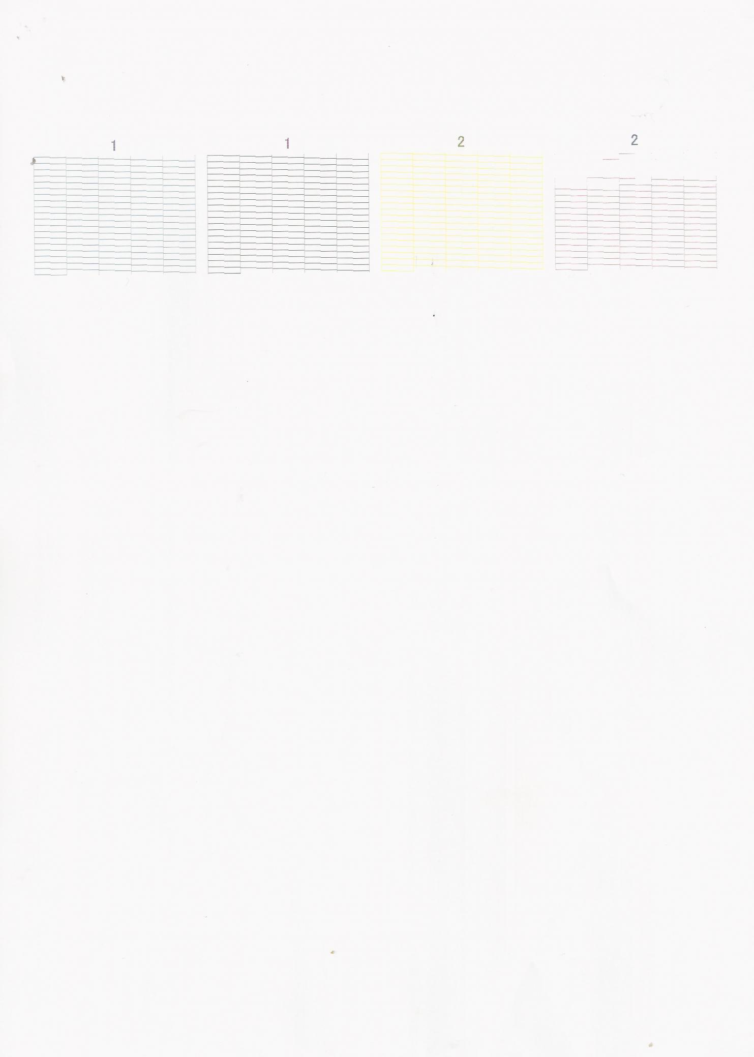

socialgiraffe;78251 wrote:It looks to me as if there are a few blocked heads. What did the nozzle check produce?
It didn't say anything, I cleaned the heads a few times then did a flush.
Re: Ricoh SG3110n
The nozzle check/test print will print out a chart showing if there are any/how many nozzles blocked. Looking at the prints though, it does seem you have some blocked nozzles, or there is a fault with the new cart not delivering the ink to the printer properly (which would have a similar result on the test print)
You should contact Sawgrass (PM them on here maybe) and/or who you bought the new ink cart from.

Here is Tania's nozzle check after a head clean. You need to contact Sawgrass as mentioned above. Barbara was on here earlier so you may just catch her...
[ATTACH=CONFIG]2036[/ATTACH]

I contacted Sawgrass who gave me a process to follow. The final result remained the same, The Nozzle check was not consistent. I am now waiting for a response as to whether they will replace the machine and inks as I only purchased it in February and is only used to produce products for the charity. Fingers Crossed, I have over 400 items to sublimate before the 8th and 9th November. Thank you everyone for advice and help to resolve this.
