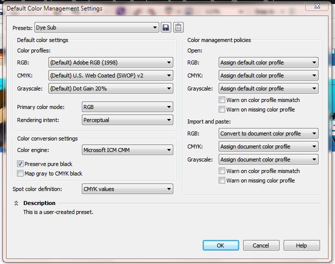

[ATTACH=CONFIG]2016[/ATTACH]
I've followed the sawgrass settings, cant seem to get the same results though.

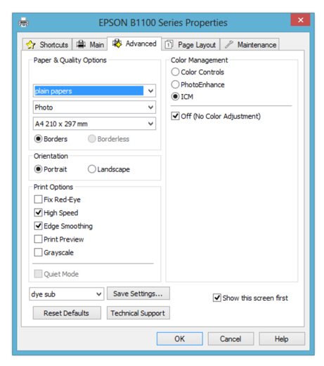

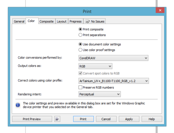

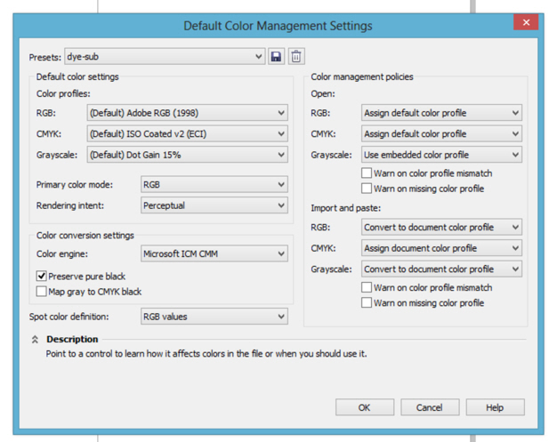

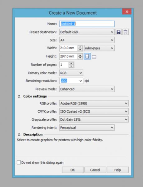

These are all my settings and work great.
I use Sawgrass Artainium ink with a Epson B1100 printer.
vB_ID:2020
